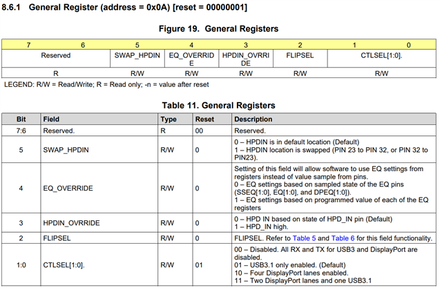

The key registers that the PD will need to set are:
0x0A bits [2:0], this will determine the alt mode configuration. and the flip orientation of the USB type-C connector.

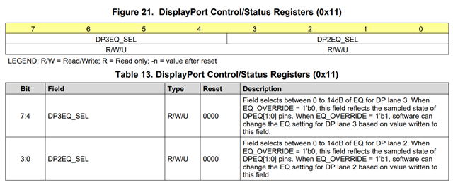

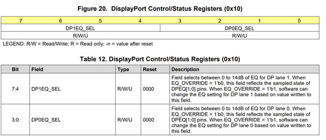

The other registers to track are the EQ registers which will control the compensation provided on the signal. These registers are enabled by setting 0x0A bit 4.
These values will need to be tuned based off of your PCB board and the losses associated.

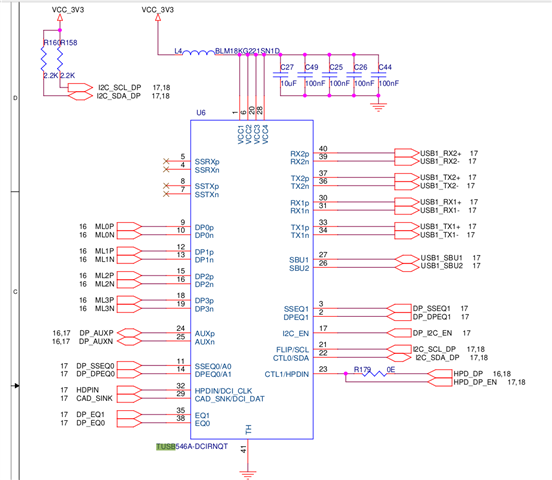

this is my tusb setup we are not using the dpaux and the usb 3.1 we are just converting the MLP and MLN with four lane display what will the register values that need to be used
for 4 DP lane, x0A is 1A or 1E (flip)
for AUX-SBU: x13 is 90 or A0 (flip)
EQ setting is based PCB trace length.
