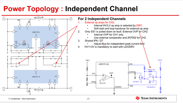

LM5171-Q1: LM5171-Q1 Peak current Limit for 2 seperate channel currents
Part Number: LM5171-Q1
I requires a clarification regarding the Ipk current limit settings, it is shared between 2 channels, If I am using 2 separate channels (Dual output with different output and current), how I can set the Ipk limit for each channel, since only one Ipk limit pin is available.
