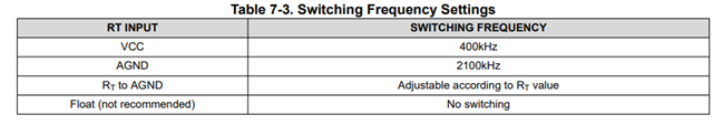

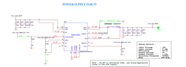

This part we are using in our design, it is unable to acheive 2.1 MHz
As per the datasheet,

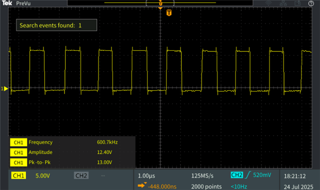

After,  Pull-Downed the RT pin to the ground, Unable to acheive 2.1MHz, here we can acheive only 600KHz
