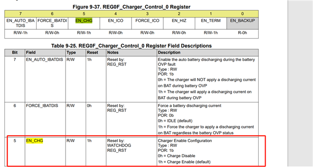

    The charger OTG is disabled when EN_OTG bit is written to 1.  If EN_CHG bit is set 1, the charger immediately starts charging when EN_OTG is written to 0. If there is no input voltage at charger's VBUS pin, the charger auto enters HiZ mode.

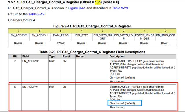

  • Hi Jeff,
    1)Shouldn't the charger OTG be disabled when the EN_OTG bit is written to 0?
    2)After disabling otg, we write EN_CG to 0, but the above phenomenon still occurs
    3)close mosfet:Write Bit6 in the REG13_Charger_Control. 4 Register to 0, and when Enable OTG, write BIT6 to 1,Wrote 0x21 to this register

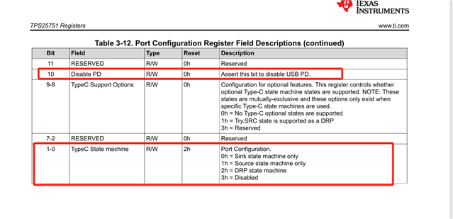

    Stop charging external devices:Write bit1~0 to 3 and bit10 to 1 in the Port Configuration Register (Offset=28h)
    Resume charging external devices:Write bit1~0 to 2 and bit10 to 0 in the Port Configuration Register (Offset=28h)
    When the battery level is less than 20%, it is possible to stop charging external devices, but the role changes from source to sink;
    After the battery level is restored to 20%, it is impossible to resume charging external devices. At this time, the role is still the role. How should charging be restored in this situation?

    Regarding 2, EN_CHG=0 stops charge current from SYS to BAT but the converter still runs to regulate SYS voltage.  If you want the converter off with input power attached, set EN_HIZ=1.
    Regarding 3, setting EN_ACDRV1 = 0 momentarily turns off (opens) the input MUX FETs but, if valid VAC1 is present, ACDRV1 output immediately turns back on.  To turn off both ACDRV1 and ACDRV2, the host can write DIS_ACDRV bit =1 in REG0x12[7].
    Something to be aware of, when TypeCState Machine is set to Disabled, the CCx pins become Hi-Z and no connection can be made (both as source and sink). This means even if a source-only device (such as wall adapter) won't be able to charge the system. Is this the intended behavior or how should the type-C port behave when operating in the "Stop charging external devices" state?
    I do not recommend setting Disable PD, this only makes TPS25751 operate as a type-C legacy device that can still either source or sink but just no PD messaging.

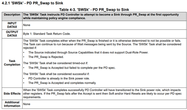

    This is possible, two options:
    1. Set TypeC State Machine to Sink State Machine only (0x0), TPS25751 will always present itself as a sink only device upon connection.
    2. With MCU, send 4CC command 'SWSk' to instruct TPS25751 to send PR_Swap request to port partner to become a sink. This command only works with port partner devices that have DRP capability.

  • . Set TypeC State Machine to Sink State Machine only (0x0), TPS25751 will always present itself as a sink only device upon connection.
    Hi Raymond,
    thanks for your reply.
    We have tried your suggestion.When the battery level is less than 20%,set TypeC State Machine to Sink State Machine only (0x0);It is indeed possible to stop charging the phone, but there is a problem where the phone is charging the tps25751. Why is this?
    when the battery level recovers to over 20%, we need to restore charging to external devices. We set the TypeC State machine to Source State machine only (0x1)
    Best Regards!
    Iris
  • Hi Iris,
    When the TypeC State Machine is set to sink only, TPS25751 can only connect as a sink device. Most smartphones these days are DRP (Dual Role Power) capable which means they can output power if a sink-only device is connected.
    What exactly is the desired behavior when the system is in "Stop charging external devices" state? Should TPS25751 remain as DRP capable but also not draw power from the phone?
