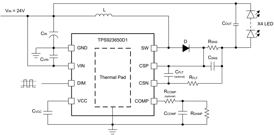

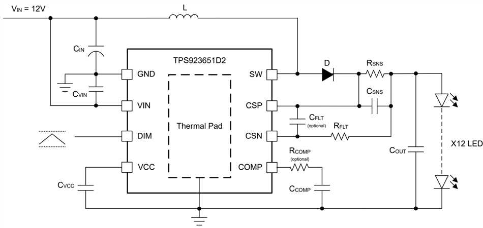

  • Please follow the below two graphical illustrations (one for Boost connection and another one for Buck-Boost connection) to design the CSP and CSN components. There are two points you should pay attention to -
    • The 100Ω resistor on the CSN line: It is necessary. The package of it should be no smaller than 0603. The power rating of it should be no smaller than 0.1W.
    • The 1nF capacitor between the CSP and CSN pins: It is optional and is for noise filtering purpose. Place it close to the CSP and CSN pins on the PCB.
    Boost:
    Buck-boost:
