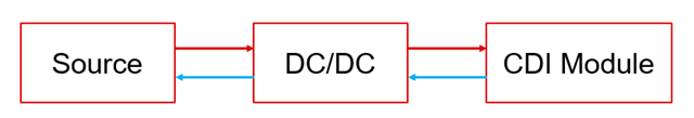

    The goal is to design a power supply that can efficiently manage the charging and discharging cycles of the CDI module that should be able to apply reverse voltage and sink current efficiently to discharge the CDI module in a shorter time frame.Instead of simply shorting the CDI module, a controlled discharge using the power supply in current sink mode is needed. This allows to manage the discharge rate and prevent potentially damaging current spikes.
  • Hi Shah,
    Thanks for the detailed explanation.
    Below is the simplified diagram, with red arrow, the DCDC is working at charging phase, so the current is flowing from source to CDI module. When DCDC is operating at discharging phase, the current will be from CDI module to source(blue), so the source will be charger to higher voltage if source is also battery. Otherwise, there will need some load to dissipate the power.
    TPS55288 can be used at CC or CV mode and is programmable via I2C, but when it is operating at sink mode, the max sink current is about 2A, it means even it is operating at sink mode, the time will be about T=C*V/I=300F*12V/2A=1800seconds.

  • The source is a DC-DC power supply, so it cannot absorb current from the CDI when the CDI is in discharge mode. However, in the lab, we have a DC-DC power supply that can operate in both constant current (CC) and constant voltage (CV) modes. In discharge mode, my colleagues simply reverse the polarity of the supply voltage to the CDI terminals, allowing the CDI to discharge into the power supply within 100 seconds. I'm not sure why the CDI module discharges when reverse voltage is applied, considering it's a power supply and not a battery. If I use a dummy load, like a resistor, to dissipate the energy across the CDI, the discharge time is very long, and finding such a high-power resistor is both difficult and expensive. The resistor must be capable of handling the power dissipation. The maximum power in the resistor would occur at the beginning:
    P_max = I^2 * R = (5A)^2 * 5 ohms = 25 * 5 = 125W.
    This is a significant amount of power and requires a high-power resistor. That's why I need a power supply that can sink current, with a high sinking capability, to discharge the CDI module quickly.
  • Hi Shah,
    That will be a question, how to dissipate the power when CDI is in discharge mode. Normally for bi-directional applications, the input source would be battery or supercap, so the battery or super-cap can be charged or discharged.
    You may need to think about where to dissipate the power when in discharge mode. Even with DC/DC, the sink current will also need to charge something or dissipate in some way.
    For the DC/DC selection, as commented before, TPS55288 can be used at CC or CV mode and is programmable via I2C, but when it is operating at sink mode, the max sink current is about 2A, it means even it is operating at sink mode, the time will be about T=C*V/I=300F*12V/2A=1800seconds. If larger sink current and less discharge time is required, you can look at LM51772 which is bi-directional buck-boost converter.
