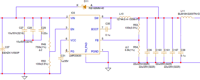

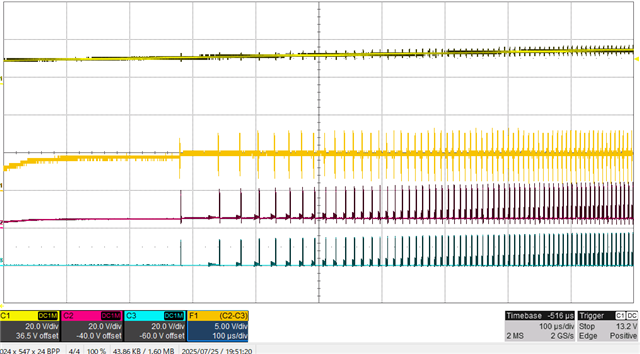

Please share your schematic and the measurement method that you are using to probe these waveforms.
Thank you,
Joshua Austria
It looks like there is a diode connected between VOUT and VIN, which is not a recommended connection for this device.

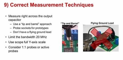

In addition, please confirm that when you are probing you are utilizing a small ground loop such as shown below:
Also, I am seeing ripple on VIN that may come from the source. Would you be able to please confirm that this ripple is not coming from the supply itself?
