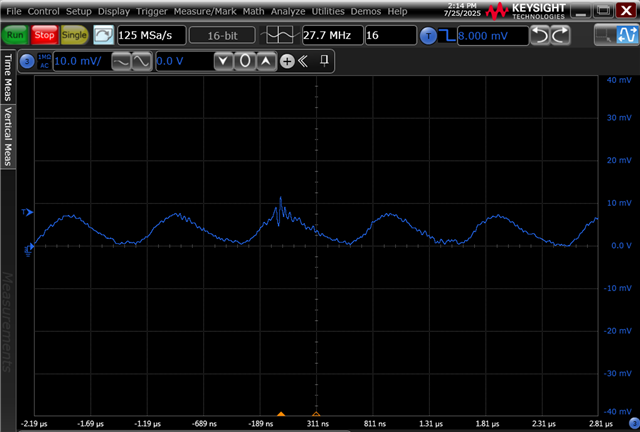

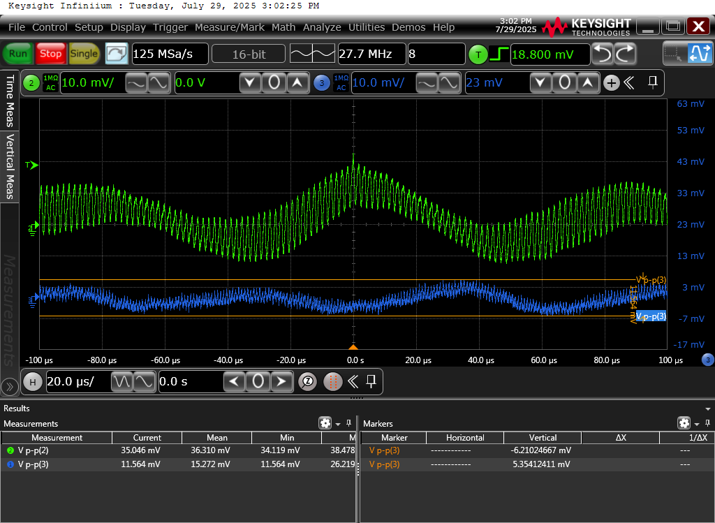

I've measured the output voltage ripple of the TPS54318. Besides the switching noise of around 8mV_pp there is a beat frequency of around 12 kHz which increases the overall output voltage deviation to 16mV_pp.
Is this due to the internal voltage regulation?

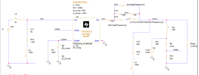

    thank you for your idea regarding the compensation network. It is from a existing design and does not seem to be ideal. I checked it quickly in Webench and it did not throw any errors back then. I am not able to plot them together in Pspice:
    This is the schematic:

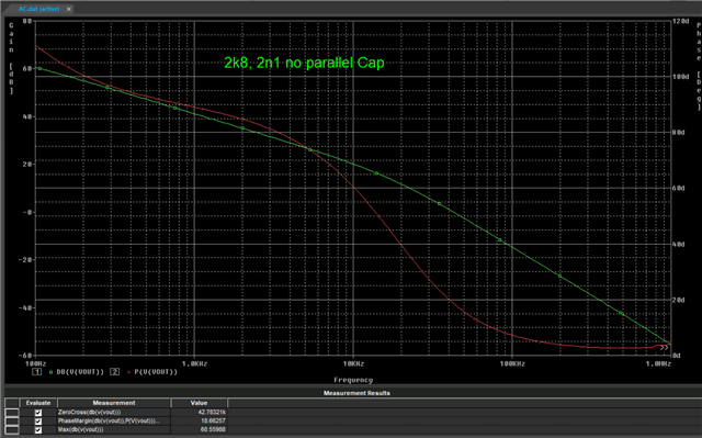

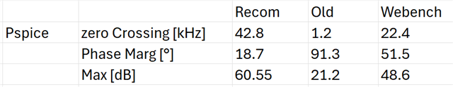

    here is your recommendation (ZeroCross(db(v(vout)))    42.78321k  PhaseMargin(db(v(vout)),P(V(vout)))-180    18.66257 Max(db(v(vout)))    60.55988)

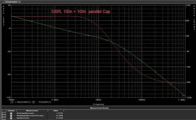

    Vs the current design: (ZeroCross(db(v(vout)))    1.17147k PhaseMargin(db(v(vout)),P(V(vout)))-180    91.32958 Max(db(v(vout)))    21.21028)

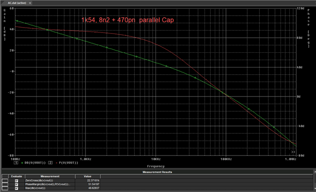

    Vs. the webench Tool
    Might the limited zero crossing BW the issue here?

  • Hi Moritz,
    Thanks for running the sims and summarizing. I see the C4 value I recommended was too low. The value needs to be higher like what Webench recommends so that the zero from R3 and C4 comes in at a lower frequency and gives a phase boost.
    With the current compensation you have on your board, the cross over is quite low. However the phase margin looks good. It could be that the PSRR of the device is low at higher frequencies due to the low bandwidth. Can you also check on the input supply if it has any noise at 12KHz? If it has, it might be passing through to the output without much attenuation.

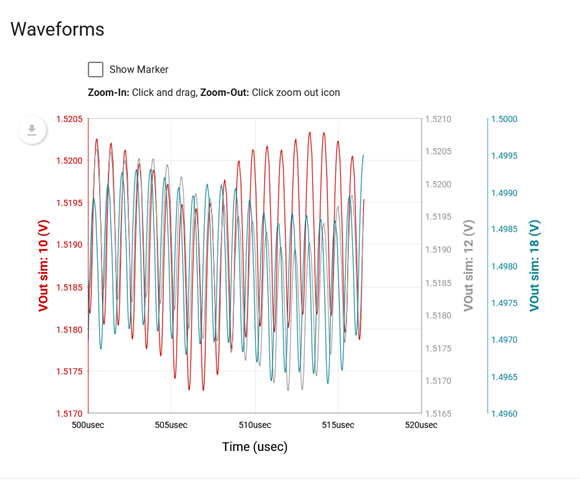

  • Hi Varun,
    I was playing around with the values in Webench when I noticed, there is some kind of beat frequency visible as well.
    This usually independent of the values for the type II compensation. Is this some kind of artifact from the current mode control?

  • Hi Moritz,
    My feeling is that this oscillation is just related to the implementation of the Pspice transient model. I can check if I have an EVM of this part and then test it in the lab.

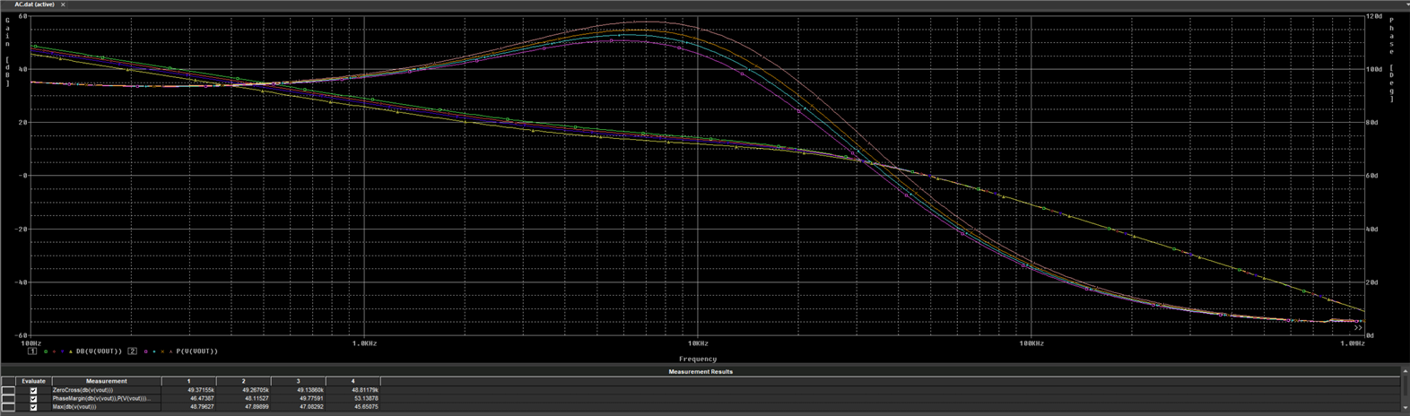

    I adjusted the compensation to C4 = 10nF , R3 = 3.3k. C5 = NC.
    Which results according to PSpice in:
                                                             I out            1mA               250mA         500mA           1A
    1    ZeroCross(db(v(vout)))                                  49.37155k    49.26705k    49.13860k    48.81179k
    1    PhaseMargin(db(v(vout)),P(V(vout)))-180     46.47387      48.11527      49.77591      53.13878
    1    Max(db(v(vout)))                                            48.79627      47.89899      47.08292      45.65075
    I tried to maximize the BW to reduce overshoot.
    The beat frequency was also reduced to 10mV (before 16mV), which shows the PSRR was increased by increasing the loop BW.
