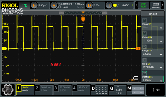

    Input voltage is 12V and output voltage is 12.6V.

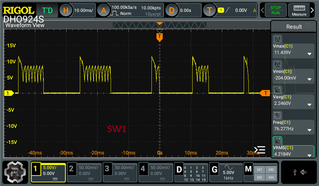

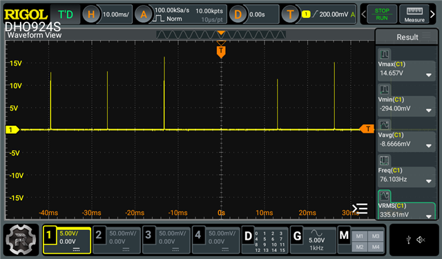

    SW1
    SW2
    Let me know if the new MOSFET has any improvement. The waveforms shown do not look like what I expect for 12V in and 12.6V out.
    In the meantime, can you use the ADC to measure the input current and output current? The current draw of 5 A should not happen under these conditions when charge current is limited by hardware to 1.6 A. I wonder if there is a short anywhere on the board.

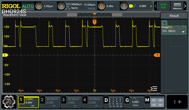

    Was there any current drawn from the input when there was 12 V input supply? There might be a short circuit somewhere that is causing the power loss. Do your registers report anything in the status, fault, and flag registers? Can you provide waveforms of the input/output current and the SW nodes?
    Michael

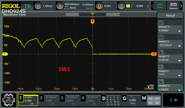

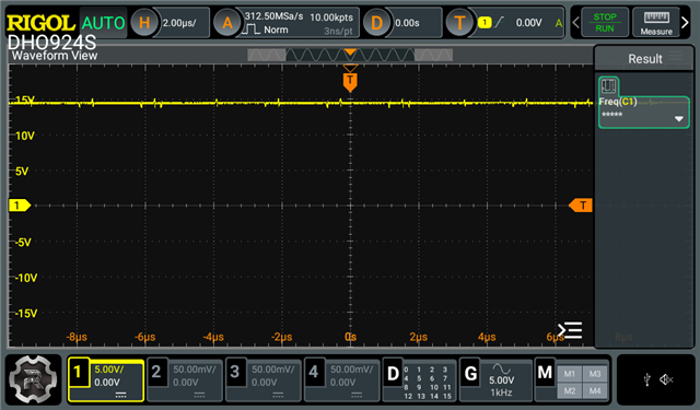

    Input current is fluctuating between 1A and 2,5A at 12 V input (I can't provide input/output current at the moment, but maybe you could help me with this information). There is no short circuit. REGN is 5 V at all times. STAT1 ON (pulled low). STAT2 is off
    SW1
    SW2:

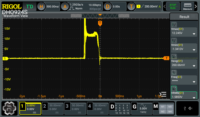

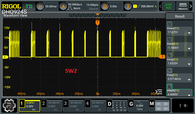

    After some time (few minutes) current from power supply drops to 200 mA (not fluctuating) and noise from inductor changes. At this moment STAT1 and STAT2 and PG is pulled low (to GND). Inductor continuous to heat up (60-70 degrees). SW2 at that time:
    Could something like this be caused by badly routed PCB? Inductor and FETS are from reference design at this moment

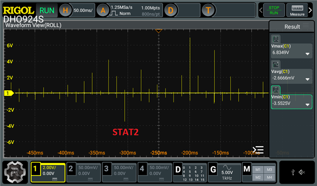

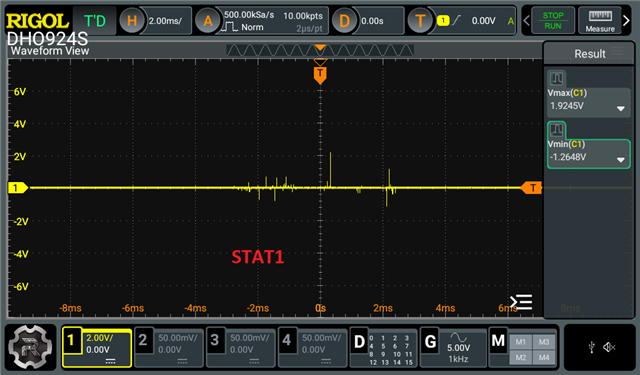

    Was this confirmed by a waveform? STAT1 and STAT2 could be flickering faster than the eye can see. Based on these waveforms, the charger is beginning to charge and then stopping charge. This keeps happening repeatedly.

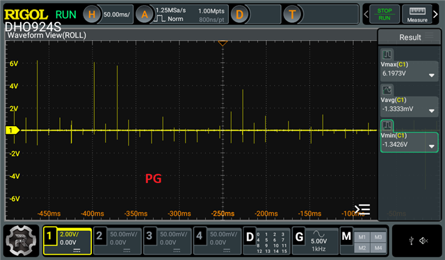

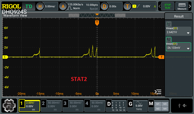

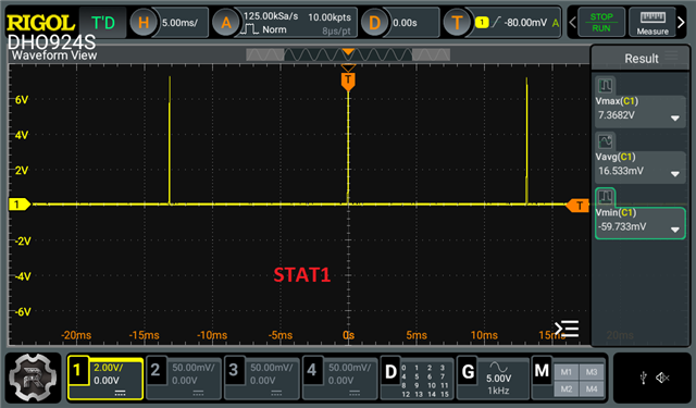

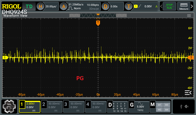

  • "Was this confirmed by a waveform? STAT1 and STAT2 could be flickering faster than the eye can see. Based on these waveforms, the charger is beginning to charge and then stopping charge. This keeps happening repeatedly."
    I took waveforms of PG, STAT1/2 when input current drops to 200mA and charging stops:
    This is status pins waveforms when some kind of charging happens and input and output current fluctuates (previous message first 4 waveforms):
    "Was PG not pulled low before? STAT1 and STAT2 being low indicates a charging fault. Can you read via I2C what this fault is. This would be in registers 0x21 to 0x27."
    PG is always pulled low. I am trying to design this to work in standby mode, but if nothing else helps I will try to read these registers this week.
    That makes sense. I2C would be helpful for debugging though. The simultaneous on states of STAT1 and STAT2 indicate a charging fault, but I won't know which one or what to look at without access to the registers.

    This seems that the boost mode is more stable. The output voltage is 12.6 here, correct? That should be 4 A max on the input based on the charge current. If boost mode is more stable, I think the issue may be related to the SW1 side of the board. The SW1 waveform also looks incorrect on the scope screenshots. Can you check the FETs for any shorts from Gate to Drain, Gate to Source, Drain to Source? It would also be helpful to make sure that the BTST1 circuit is working properly here.
