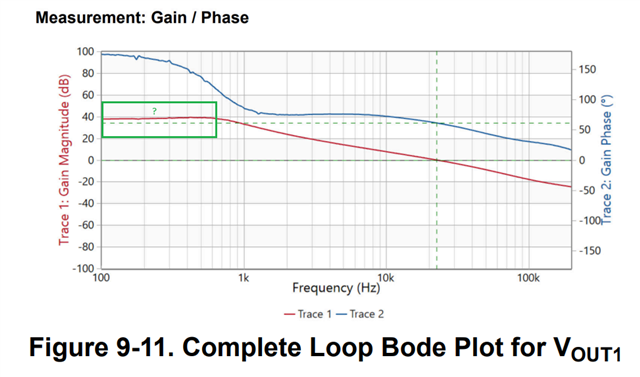

I was wondering if you could explain the phenomenon of this flat line on the total loop measurement. Typically for a compensated current-mode regulator, we have roughly a straight line but the plot in the datasheet shows that there's a flat line on the magnitude below 1kHz.
Could you please explain why this is the case?
  • Hi Nabil,
    Current-mode regulators do not inherently have a pole a 0Hz, so depending on the configuration of the converter that pole can be seen at higher frequencies like in the above plot. Sometimes this pole is at a very low frequency, so the plot looks like it has a constant slope from the very beginning. If that pole is at a high enough frequency, then the flat part of the gain curve will be visible on the plot.
    "Understanding and Applying Current-Mode Control Theory" is a great document that also contains the transfer functions of various current mode converter topologies if you are interested in learning more.
