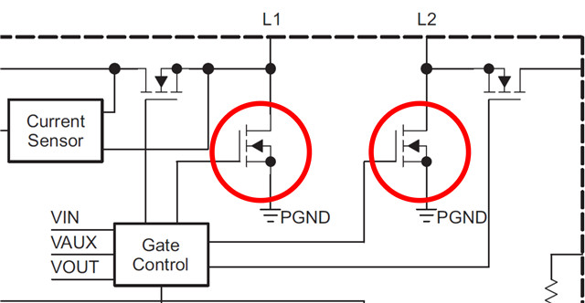

Hi support team all.
Switching behavior
Is it possible for both internal FETs in the diagram below to be turned on at the same time?
If so, under what conditions does this occur?
Currently, it has been confirmed that two FETs are turned on at the same time, which wastes energy in the inductor and prevents the output voltage from rising to the set voltage.

  • Hi DH,
    Thank you for reaching out. What is Vin, Vout, Iout of the test? Can you also check inductor current waveforms? It seems that IC works in PFM mode, so it is normal behavior of skip phase.

  • Hi Mulin-san
    I share the additional information below.
    Vin=4V
    Vout=6V
    Iout=90mA
    I have an additional question.
    Is it really possible for two FETs to be ON when operating in PFM mode?
    The output is set to 6V, but it's dropping to 5V, causing the regulation accuracy to become very poor.
    It's unlikely that the regulation would be this bad when operating in PFM mode, so is this normal?

  • Hi Mulin-san
    I have some additional information from my customer.
    When this issue was confirmed, the board was two-layer, but the device's thermal pad did not have a thermal via and was not connected to the bottle layer directly below the device.
    After adding a thermal via to the thermal pad, the same device reported a change in operation. (The FET in the first quadrant was ON, the FET in the second quadrant was OFF, and output regulation returned to normal.)
    Based on these results, could you please tell me what the cause of this could be?
    This has caused customer evaluations to halt, and in the worst case scenario, we could lose business, so we would appreciate your help.
