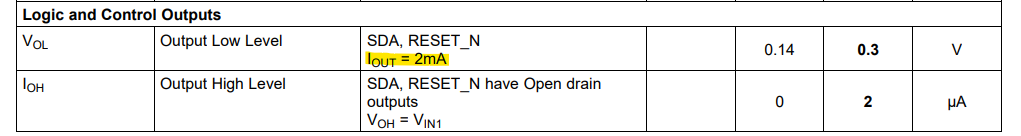

From a different thread, I understand that the maximum speed of the interface is 400kHz (here is the thread). Given this:
  • What is the maximum pin capacitance of the SCLK and SDATA pins?
  • Does the interface have glitch filtering? If so, what pulses can it handle?
  • What is the output low sink current for the interface?
Hope to hear from you soon.

    • The pin capacitance of SCL and SDA pins are not characterized and not specified in the datasheet.
      It is recommended to estimate this with a value of 10 pF maximum
    • As in compliance with the standard I2C specs, there is a 50 ns max deglitch filter for fast mode.
    • Output low level sink current is given as 2mA:
    Hope this helps to answer your questions.
