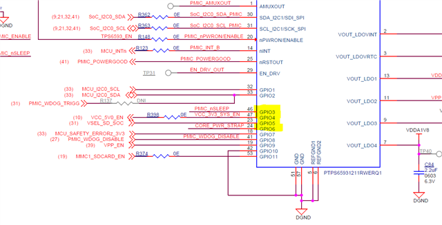

Hi All,
I have a question about the TPS65931211.
In the SK-AM62A-LP EVM schematic, GPIO3/GPIO4/GPIO5/GPIO6 are 3.3V input signals or 5V output signals.

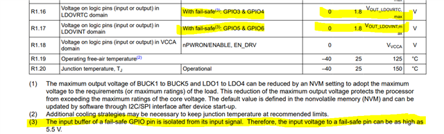

In the TPS6593-Q1 datasheet, they are 1.8V signals as shown below.
The notes say that a 5.5V signal is OK for a fail-safe GPIO, but can GPIO3/GPIO4/GPIO5/GPIO6 be input up to 5.5V?
