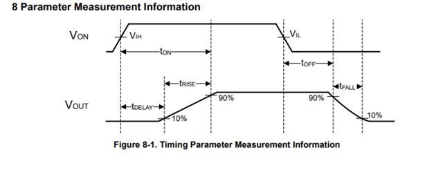

Hello TI,
For a load switch, Turn-on time is normally defined as On delay + On rise-time, similarly, Turn-off time as Off delay + Off fall-time.
However, SLVSFK0B and SLVSI93A currently have most Turn-off times as shorter than the corresponding Off fall-time for the TPS22991 / TPS22991I parts.
Is this correct, please?
