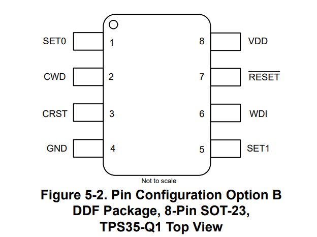

Hi, is the PIN configuration B of TPS35-Q1 available?

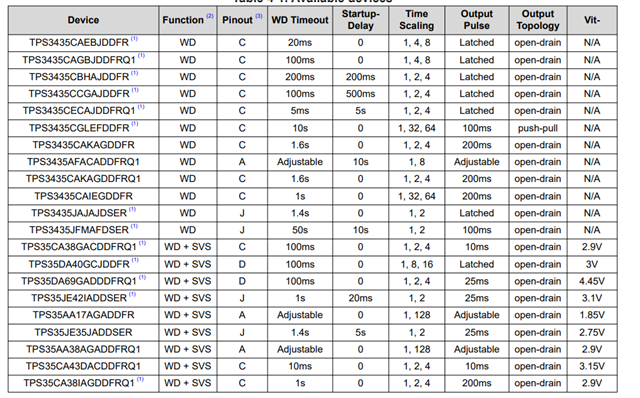

Option B does not appear in the list of available devices.
Hi Fernando,
We plan on RTMing a TPS35B-Q1 variant, TPS35BA38AAADDFRQ1, in September of this year. Does this orderable part number variant meet your needs?
