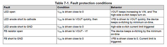

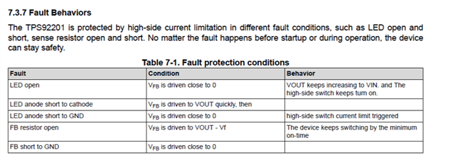

I am looking into the TPS92201 fb short to ground condition, but need extra details on how the fb short to ground has a mitigation.
Can you please provide additional details.
