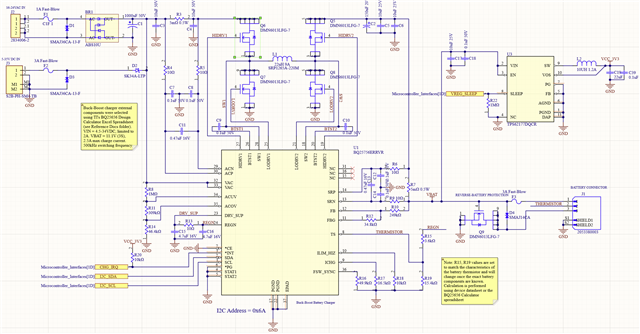

It looks like my earlier thread got locked due to inactivity. I still cannot get this circuit to charge a battery, despite a handful of hardware rework attempts and edits to the I2C configuration bytes. These serial debug messages are produced by the host microcontroller when a benchtop supply is turned on to apply a VAC input to this charger:

Here is my original, unmodified schematic:
So far, I have attempted the following fixes:
  • Add thru-hole BAT41 Schottky diodes between DRV_SUP and each of the BTST nets
  • Change R13 in my schematic to 0 Ohms to remove limitations on DRV_SUP current
  • Change switching inductor to from 22uH to 10uH
  • Put a 470uF electrolytic capacitor downstream of the input-side sense resistor to better balance capacitance
  • Solder RC low-pass filters in parallel with the ICHG and ILIM_HIZ resistors
  • Upon realizing that the STAT1, STAT2, and PG pins were directly connected to ground in my schematic, I disabled those pins via I2C write.
  • Disabling ICHG and ILIM_HIZ pins via I2C write and replacing those resistors with 0-Ohm for full firmware control
  • Since my present battery back does not have a thermistor, removed R15 and replaced R19 with 0 Ohms, then disable the TS pin via I2C write

After the initial register writes, the host microcontroller polls the registers for status in response to any activity on the interrupt pin, as well as periodically to monitor state of charge.
I have used similar TI parts in previous designs, but this one just refuses to work no matter what I try. Based on what you see above, is there something I'm missing?
