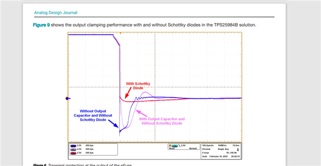

  • Hi Kunal:
    Does the note in the journal account for the Schottky diode? When I read the journal, it said the measurements did not include capacitance and the Schottky diode. Wouldn't the Schottky diode, which is very fast, mean that very little output capacitance is required?
    CNH
  • Hi CNH,
    Can you please share screenshot of the note?
    It is true if you have schottky diode at output you need less cap at output for preventing VOUT going -ve.
