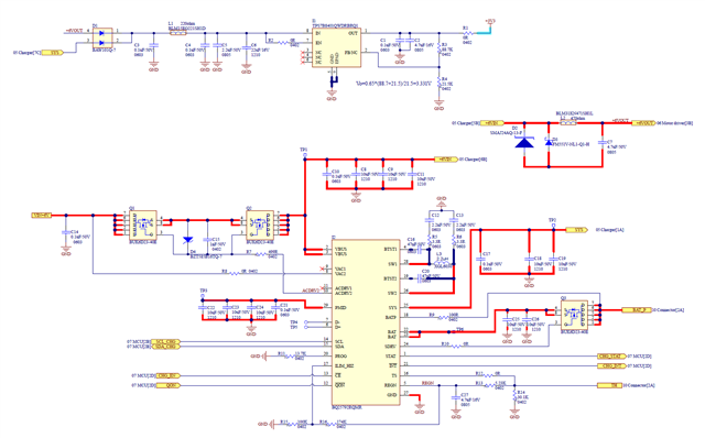

  • Hi Jeff,
    Thanks for clear comments. If we want to use OTG function, can we use VBUS2 only?
    May you help also review the circuit for us? Thank you.
    Roy

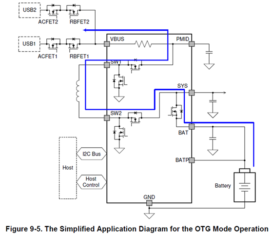

  • Hi Roy,
    The datasheet "Section 9.3.7.1 OTG Mode to Power External Devices" states the following:
    "For swapping the OTG output from port 1 to port 2, assuming EN_ACDRV2 is already 0, the host has to set EN_ACDRV1 = 0 to turn off ACFET1_RBFET1 first, which causes the converter to stop switching and VBUS to drop below VBUS_PRESENT. The host then sets EN_ACDRV2 = 1, and the converter starts switching again and ACDRV2 turns on ACFET2-RBFET2, which allows VBUS to ramp up. The similar procedure can be applied to the case of swapping the OTG output from port 2 to port 1."
    Following this procedure, you can use only port 2.
    I will let Jeff review the circuit when he returns to the office next week.
