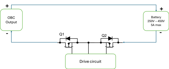

    I need to protect the same MOSFETs for Reverse Polarity, Check the typical block diagram below,
    Please suggest driver circuit for this application
  • Hi Eswara!
    A similar setup could be used here for your reverse polarity protection circuit. If you need voltage sensing/detection in any location, I would suggest the TPS4141-Q1 + comparator setup I mentioned previously. As for the switches, I would suggest the TPSI2140-Q1 again if you wish to have integrated FETs. This part can take in a low-voltage enable signal from the detection circuit or from a microcontroller (if you want more manual switching) while protecting the auxiliary circuit from the high-voltage battery and OBC.
    If you wish to have external switches, another option is to a gate driver to drive power MOSFETs like those shown in your diagram. A gate driver would interface with the detection circuit/microcontroller similarly to the TPSI2140-Q1, taking in a control signal on the enable pin to influence the output. For this, I would recommend the TPSI3100-Q1: an isolated switch driver that generates its own secondary bias supply and has dual isolated comparators for overcurrent protection. This provides a more robust solution as the secondary supply can be used for other components in the driver circuit that may need to exist on the high side, like inverting op-amps. Just as well, the added overcurrent protection will safeguard your high-voltage components with no additional cost/complexity overhead.
    Hopefully this helps! If you give me more details about the intended operation of this circuit (i.e. when Q1/Q2 should be on or off, whether voltage detection is necessary, whether you want to use external FETs, etc.) I could try to provide a more in-depth solution.
  • Q1, Q2 will be controlled by Micro Controller, Micro controller will check polarity & short circuit diagnostics, if both are okay, MCU will the Enable.
    Battery Voltage : 250V - 450V
    Battery Current -- 5A
  • Eswara,
    Do you already have a method in place for checking polarity diagnostics? If not, the TPS4141-Q1 could still provide an easy solution: it would take HV input across the battery/OBC terminals of interest and scale it down according to the divide ratio set by DIV1 and DIV0. Then, you could communicate the scaled output voltage signal (polarity included) to the microcontroller without causing any damage.
    If you wish to have a more discrete solution, you could do something along the lines of using a power diode rated for the application, configured in an inverted direction such that it only conducts current when polarity is reversed. From here, you could connect the diode to a known-value resistor ladder to scale down the voltage before it is sent to the MCU. The purpose of this is to protect the MCU from high voltages while still communicating the magnitude and polarity of voltages/currents in the system. However, because both the diode(s) and resistors will contribute to undesirable power loss and heating, I still recommend the lower-power TPS4141-Q1 solution.
    Once you have a diagnostic circuit, the switches are very simple to interface with the MCU: simply connect the controller to the enable pin of the TPSI2140-Q1 (or the TPSI3100-Q1 if you want to use external FETs). More information regarding enable voltage ranges, switching times, and other features can be found here for the TPSI2140-Q1 and here for the TPSI3100-Q1. Of course, feel free to browse the rest of our portfolio to see if one of our parts works better.
