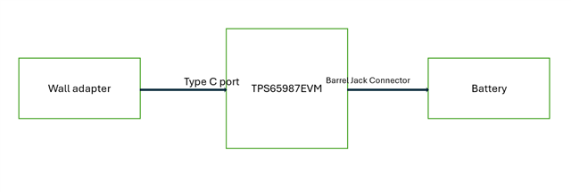

    Could you please share a block diagram of your test setup? Where is the battery being connected to? Are you using a real battery or a battery simulator?
    Aya Khedr
  • Hi Aya,
    Thank you for your response. I am using a real battery not a simulator. It is connected to the barrel jack connector of the EVM. Please find the block diagram below.
    Shwetanshu

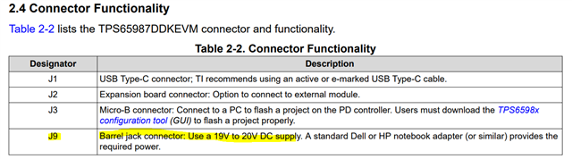

    The Barrel Jack connector (J9) is used to power the EVM (i.e. to provide power to the input of the variable DCDC converter).
    Out of the box, the TPS65987DDKEVM is configured to use the PPHV1 as sink path (J4) and PPHV2 as source path (J5).
    When connected to a Type-C wall adapter, the TPS65987 will behave as a Sink and Request a PDO advertised by the Source. In this case, PPHV1 is the sinking power path. In battery charging applications, the sink power path would be connected to the input of the battery charger to control charging a battery.
    In other words, a battery should not be connected to the output of the PD controller. The PD controller is responsible for negotiating the required voltage/current levels and does not charge a battery on its own.

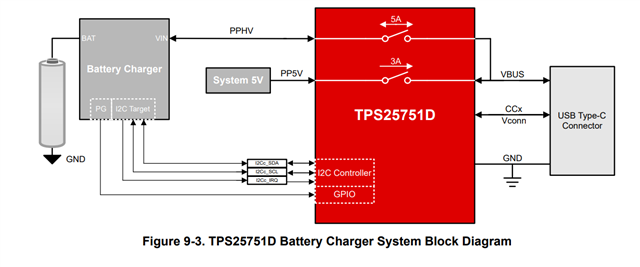

    Also, please note that the TPS65987DDK is not recommended for new designs. We recommend the TPS25751 for DRP battery charging applications.
    The TPS25751 has integrated I2C support for TI supported battery chargers. We also have reference designs such for PD+BQ applications.

    I recommend looking into the following EVM used to evaluate both TPS25751+BQ25798 for battery charging applications: https://www.ti.com/tool/USB-PD-CHG-EVM-01
