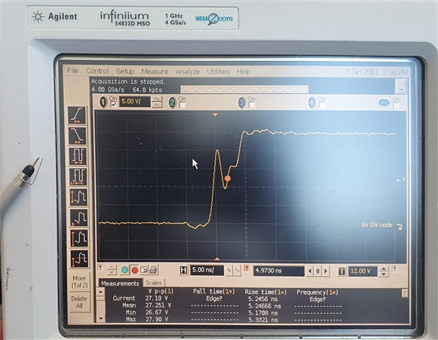

As a part of the Proof of Design I am performing on my custom HW, which utilizes LMR51440SDRRR to convert 24V to 5V,
I measured the switching node between the LMR51440 and its inductor. The rising edge has a weird shape.
The voltage rises about 80% of Vin, then drops to 60% of Vin, then rises and finally reaches Vin (+minor overshoot). See image.

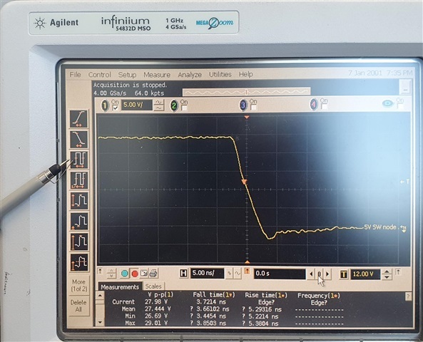

The falling edge does not show this phenomenon. See image.
Increasing the load on the buck output from ~0.6A to ~3.6A causes the peaks to grow farther apart (80% vin -> 90% vin, and 60% vin -> 20% vin).
Increasing the boot capacitor from 100nF does not make a visible difference.
Adding a series resistor (0.5 Ohm - 2.7 Ohm) to the boot capacitor reduces the first peak's value (2.7Ohm causes ~70% of vin), but does not change the overall shape.
Adding a snubber (100pF, which is as large as I can practically add regarding power dissipation) to the switch node increases both peaks voltage levels and causes an overshoot and ringing. It does not change the overall shape. It also adds ringing to the falling edge, which is unwanted because it looks fine.

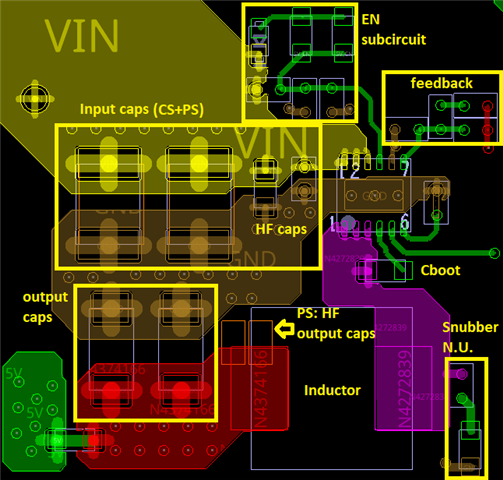

    The design mostly follows TI's recommendations. See attached image for layout.
    Schematic description:
    1. pin RT shorted to GND (SW frequency measured ~860kHz + spread spectrum).
    2. input capacitors 100uF electrolytic (not shown in image) + ~20uF bulk MLCC after derating + 100nF 0402 + 1nF 0402. MLCC As close to the IC as possible.
    3. boot cap 100 nF 50V
    4. inductor 4.7uH nominal, RDC 40mOhm max, I saturation 10A (20% inductance drop)
    5. output caps ~70uF bulk MLCC after derating + 100nF 0402 + 1nF 0402. As close to the inductor and input caps as possible. other capacitances are farther away.
    6. The EN subcircuit enables the buck at vin = ~18V, which means it is probably not related.
    Unfortunately I cannot perform an ABA swap with an EVM, but I measured the same phenomenon on more than one board.
    Perhaps you could access and EVM and check if you measure the same phenomenon? I'm aware the layout, the surrounding components, and even the specific IC part number are different, but I still think theres value in recreating the same measurements in a different setup.
    configuration: 24V input to 5V output, 0.6A load.
  • Hi Amit,
    Looking through your layout, I do see a couple notes of improvement that are also likely to affect the SW node ring.
    • There are thermal reliefs on the input, SW, and GND traces. This overall increases the inductance/impedance between the components connected to these nets and their pins. Each of these thermal reliefs has the potential to create the ring seen on SW.

  • Thank you, Joshua.
    Regarding other layers, there are several more layers in the board. In this section of the PCB, there are only GND layers and the output power layer. There aren't even any signal traces.
    The bottom layer has more input and output bulk MLCC caps (exactly under the top bulk caps), and the HF output caps (marked in the above image).
    The feedback trace is also pulled from the bottom, back towards the components on top.

  • Hi Amit,
    I will source a board and get back to you with that. Theoretically, any extra impedance/inductance on the SW node can affect the SW node ring.
    Are you able to send those layout files for review?

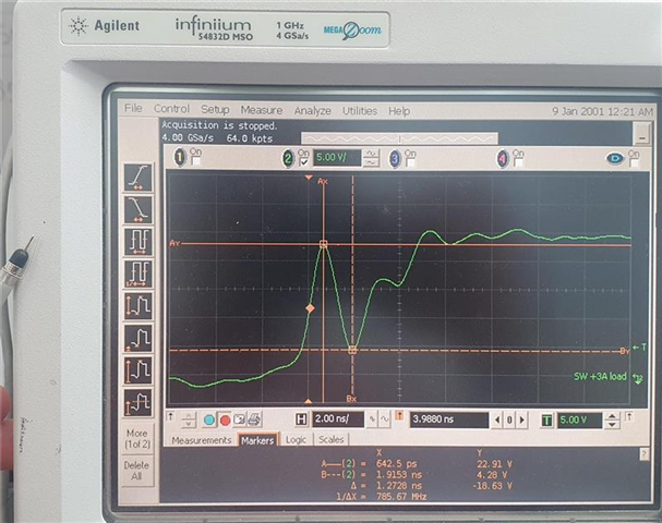

  • Hi Amit,
    Sorry for the delay. On the EVM, I do see a first "pulse" on the SW node at a 600mA load. However, as load increases, this pulse disappears, so this looks to be a factor of light load PFM operation for the device. At 3.6A, the SW node waveform only has a rise to VIN (+minor overshoot) without a preemptive pulse.
    However, in reading your phenomena, you did note that the device still experienced this SW node ring at a 3.6A load. Are you able to share what this waveform looks like at 3.6A?

  • Hi Joshua,
    Increasing the load from 600mA to 3.6A emphasized the phenomenon. Attached image is with 3.6A load.
    Since the opposite happened on the EVM, I'm led to believe the cause of the phenomenon is an issue with my layout.
    I'll reconsider my options, and if I'll have any more questions I'll let you know.
