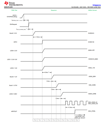

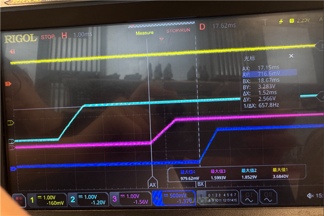

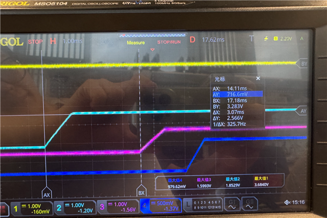

We are now using TPS6521904RHBR to power AM623, we tested the power sequence between VDDA1V8 and VDD_1V2; VCC_CORE and VDD0_CORE, and it does not match the criteria from spec.
Is there any debugging approach ?
VDDA1V8 C84 VDD_1V2 C85 >4.5 3.04 FAIL
VCC_CORE C81 VDD_CORE C155 >1.5 0 FAIL
