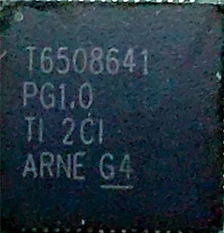

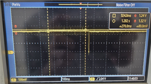

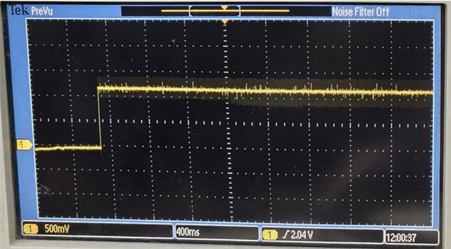

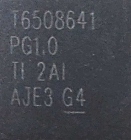

Hi Team,
We have design a custom design using the Zynq MPSoC and TPS6508641RSKT PMIC, in which the LDOA3 output is unused and connected with a 4.7 µF output capacitor. After several days of testing in some board, we observed that the board began rebooting continuously upon power-up. To resolve this, we added a 1 kΩ resistor in parallel with the LDOA3 output capacitor, which successfully eliminated the reboot issue. Although we attempted to mask the LDOA3 fault using the PWR_FAULT_MASK2 register, this was ineffective because the register resets to its default OTP configuration on each power cycle.
Kindly let us know the recommended method to permanently resolve the booting issue.
