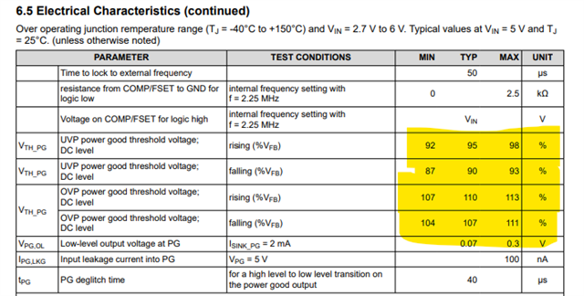

Hi Farheen,
What is the time delay from the VOUT stable to PG pull high?
BR
FANBIN
Could you help provide the waveform or the report?
is this the datasheet spec?
Hello Fanbin,
There are UVP and OVP thresholds which tells when PG is pulled high...
