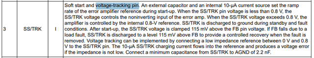

Hi team,
My customer would like to achieve class H solution based on the reference design of TIDA-020033, and he considers LM5146-Q1 for the dcdc converter to track the output voltage. Is LM5146-Q1 possible to use as LM5123-Q1 does in the reference design?

  • Hi Taru-san,
    Thank you for the reply. What I want to know is that the voltage tracking function works as a voltage tracking pin of LM5123-Q1. I think users can utilize the voltage tracking pin of LM5146-Q1 for class H solution.

  • Hi Yamamoto San,
    I agree with your point here - however, from what I understand from the TIDA-02033 - the whole point of using LM5137-Q1 is to generate a boosted output for the amplifier stage (i.e. Vout > Vin). It all depends on what your input voltage range and output voltage ranges are.
    If you are always in the stage of Vout > Vin - then you have to use a Boost Converter. If the stage is Vin > Vout - the LM5146-Q1 can work!
    Again, I recommend you speak with Donovan and Matt - explaining to them your system requirements.
