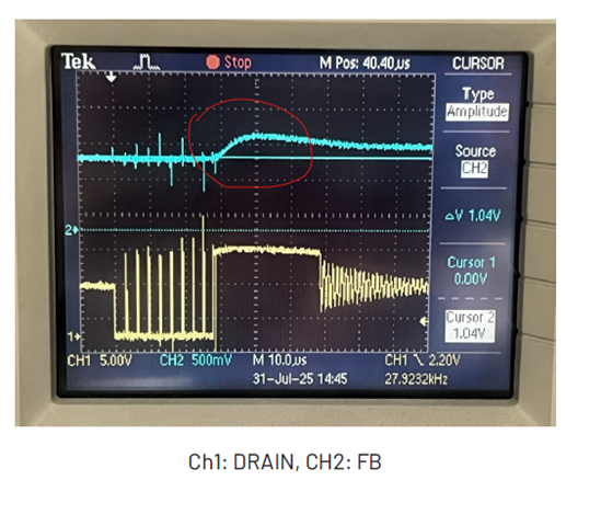

  • Hi Gordan,
    I have gone through your scope plots and found that your device is entering into over voltage protection (OVP) (the OVP threshold is 1.13V) and this stops the gate switching. As you are using the external current loop to control the output voltage; thus, you need to check this control loop such as, compensation for the external current controller.
    Moreover, your CS signal have very high coupled noise. Can you please send the CS signal again with very small ground loop connection. And make the scale 20mV/division to increase the resolution of the signal.
    Hassan

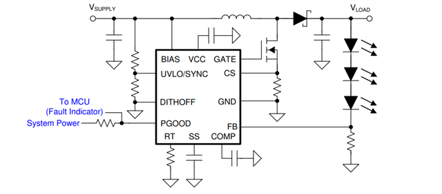

  • If you want to design the LED driver with LM5156, you can also try with the recommended LED design in the datasheet.
  • Cannot use this schematic due to the fact that to be programmable, I would need to use different mosfets and resistors in series to set Rfb resistance. In this case I will have enormous looses (1V @ 600mA = 0.6W, that means 10% looses only on Rfb) that I cannot accept.
  • This solution does not need to be programmable. MCU is only to detect the fault signal, but it does not have any link to operation.
    Yes, it is true that with this solution you have losses in the resistor, but it is very cheap solution.
    Whereas, to have a correct current loop operation, you need to optimize your current loop controller correctly.
  • Hi Hassan,
    Attached is the report of the modified schematic. I removed OpAmp and connected FB directly to Rsense = 1.6 oHM (approx. Iout = 600 mA). I shorted Rcs to ignore overcurrent on the Mosfet and removed resistor partition on UVLO so UVL0 has been disabled.
    The result is the same: still in burst mode. It seems that the FB pin is not changing fast enough so there is an voltage overshoot on the output while controller is in idle, due to inductor discharge. Perhaps I have to remove 200 uF capacitors, but I remember that I tried it at the beginning without success.
    The calculator remained the same, only the oscillator is slower (from 300 to 100 KHz).
    Any idea? I am out of ideas :( Disappointed

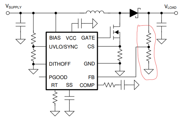

  • Hi Gordan,
    Okay, you can send me the altium files for your design.
    Meanwhile, you can try with normal feedback divider circuit and check the behavior of the device.
    Just set the output to any voltage in your desire output voltage range, and apply different loads to check whether the device switch properly or not.
    Hassan
  • I did it. It is not extremely stabile, but it is far away from the problems I found in constant current mode. I am using my original schematic diagram and components, not the one from the calculator, since I started this experiment with the new board (sample), the old one was too much modified.
    My next step is to do the reverse move towards constant current and check where is the problem.
