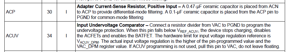

Hi team,
There are no definitions of pin31 to pin33 in BQ25820's datasheet. Are you missing it when you draw the datasheet.
Could you tell us them now?

Hello Gary,
The BQ25820 datasheet has this information. This has already been fixed in the updated datasheet:https://www.ti.com/product/BQ25820
