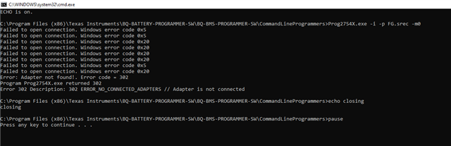

BQ34Z100-G1: Prog2754.exe Not working Command Line Interface(CLI)
Part Number: BQ34Z100-G1
Other Parts Discussed in Thread: EV2400, BQSTUDIO
Trying to download the SREC file to a fuel gauge using CLI. however I keep getting a 302 Error which is that its not recognizing the adapter. I am able to program just fine using the BQStudios GUI. This is just a simple command that I am running "Prog2754X.exe -i -p FG.srec -m0".  wondering if this has something to do with the adapter do i need a MKS-SAI-001 or am i fine with the EV2400 EVM Interface Board that i am using?
