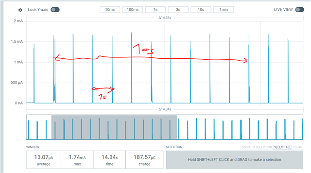

I set voltage time to 10s, deep sleep Voltage time to 20s, wake check time 5s using BQstudio,
and still saw current spikes (~2mA) every 1sec.
According to  sluuc54b page12,
"The device updates RemainingCapacity() every 1 s, based on the last measured current."
How can i change the RemainingCapacity updates time using BQstudio?
