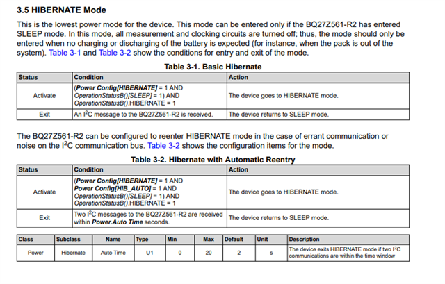

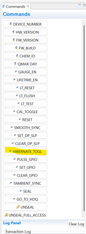

Hi
How can I enter the fuel gauge into Hibernate Mode using the BQstudio?
Please provide simple sequence of steps.
How can I be sure it is in Hibernate Mode, as far as I understand i2c communication disables Hibernate Mode.
Thanks Uri
