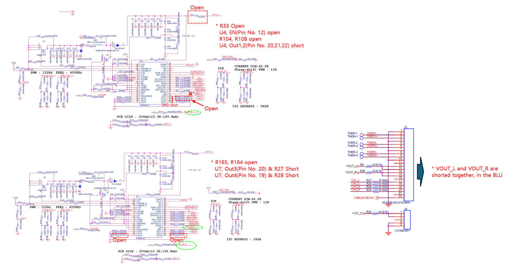

About 4 months ago, I inquired regarding driving LEDs using two LP8866-Q1 ICs.
  • Connection method:
  1. LED configuration: Anode 1 and 2, Cathode 1, 2, 3, 4, and Anode 1 and 2 are shorted together.
  2. LP8866-Q1 #1 drives Anode 1, Cathode 1 and 2.
  3. LP8866-Q1 #2 drives Anode 2, Cathode 3 and 4.
This is how it is driven (although it is not the recommended method).
Both ICs share the same 24V input power supply, and the total current measured on the 24V input equipment is about 600mA.
However, about 10% of the time, instead of 24V, a voltage around 0.6V is measured, and the current spikes to 1000mA to 3000mA.
Could this phenomenon be caused by shorting the two ICs’ Anodes together?
I would like to understand the mechanism behind this.
For reference, the EN pins are connected together and used simultaneously.
If the EN pins are separated and enabled with a time delay, would that improve the boost circuit error?
  • And could this cause only the 4th LED string to experience overcurrent, with all the current flowing through just the 4th string?
    Only the LEDs in the 4th string become excessively bright, and thermal damage has been confirmed.
    Could this be caused by using the two LED driver ICs with their anodes tied together?
  • And more than 1000mA is sometimes measured on the -24V line as well.

    We have made a design change.
    That is, even though we temporarily modified the concept from driving LEDs with two LED driver ICs to driving with a single LED driver IC, the same issues of voltage drop and overcurrent still occur.
    In our measurement under normal operating conditions, the current and voltage were 550 mA and 24 V respectively.
    However, in 1% of cases, we observed in the log that the system drives at 0.6 V with more than 1500 mA.
    Currently, we are using 90 mA per string in 4 strings.
    How can we improve this phenomenon?
    We are sharing the circuit diagram of the LED driver IC block for your review.

  • Yes, that’s correct.
    1500mA is the output current, and 0.6V is the input voltage.
    • Normal output current: 550mA
    • Abnormal output current: 1500mA
    • Normal input voltage: 24V
    • Abnormal input voltage: 0.6V
    Could such a phenomenon occur if a momentary short happens?
  • Additionally, if a short occurs,
    is it possible that excessive overcurrent happens in a single LED string?
    We always observe that only one string of LEDs becomes excessively bright and shows signs of overheating.

  • Hi, SANGYUN
    Depending on your description, one string see the short and leads to the overcurrent, pls kindly check with the LED panel connection to see what happened.
