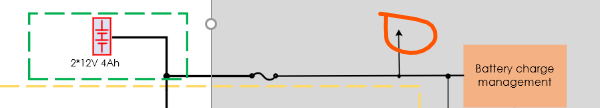

In my design, I want to judge if the battery is absent or not by monitoring the battery voltage.
The battery power input would be the same point as the battery charger power output.
When I detect the battery voltage, I will enable the battery charger firstly, I think this point voltage is the external battery voltage.
Is it right? Is this method feasible?
Hope I can get your reply soon.
Thanks!

  • Hi,Christian
    I will not use BQ25751 to detect battery is absent or not.
    I want to detect the battery voltage. But when the battery charger is enabled, the point voltage would not be battery actual voltage, is it right? Maybe I misunderstand?
    So I want to disable the battery charger before detecting the battery voltage. But I cannot be sure it is feasible. Could you please help check this method?
    And one more question is when the battery is absent, the FB voltage will be what?
    Thanks!

  • Hi, Christian
    Where are you measuring? if you our measureing at VOUT, then it should be the actual battery voltage while charging and while not charging.
    Below point circled red is the test point. Yes, it is the VOUT. I want to test this point voltage to judge if the battery is absent  or not. According to your explain, I think I could not disable the battery charger before measuring this point voltage, right? This point voltage always battery voltage.
    Thanks!
  • Hello Sun,
    Yes, That should be correct.
