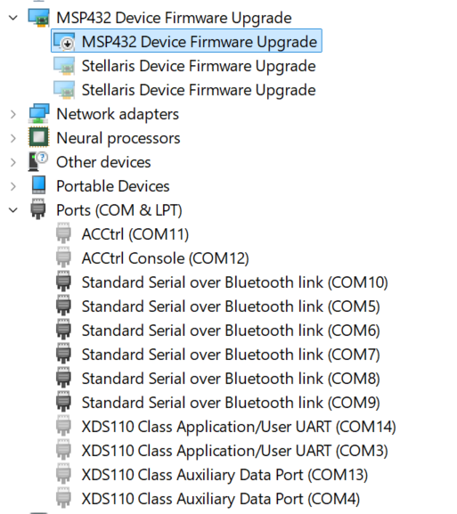

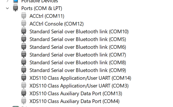

I’m using LEDMCUEVM-132 for my project. The very first time I connected the LEDMCUEVM-132 to my system, ACCtrl and ACCtrl Console were detected and also appeared in Device Manager.
After that, I wanted to flash the demo code to the board. So, I connected the XDS110 debugger and flashed the demo code using UniFlash. However, after flashing the demo code, the ACCtrl and ACCtrl Console ports are no longer detected by my system.
I have attached an image for reference. Both the XDS110 debugger and LEDMCUEVM-132 were connected when the screenshot was taken.
Miit Prajapati.

    3. I also eraser the flashed code from LEDMCUEVM-132 and try to connect LEDMCUEVM-132 board to my system. After that firmware upgrade is appear for your reference image is also attached.
    Miit Prajapati.
  • You flashed firmware meant for the MSP432E401Y Launchpad. This is not correct. Our EVM LEDMCUEVM-132 board ships with its own firmware already installed with no need to flash at all. In order to use the 664 EVM you will need re-install the correct firmware. Did you back up the original firmware before you flashed the MSP432?
