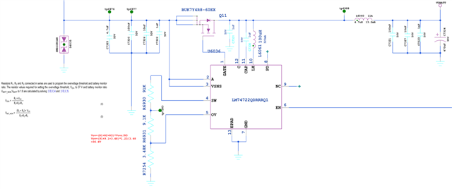

May I know if the peripheral circuit design of the chip in the figure is appropriate?The LM74722 is mainly used here for anti-reverse, short-term interrupts and superimposed AC scenarios.
Hi Jade,
The input TVS can be changed to SMBJ33CA.
Please keep the thermal pad floating.
Rest, schematic is fine.
