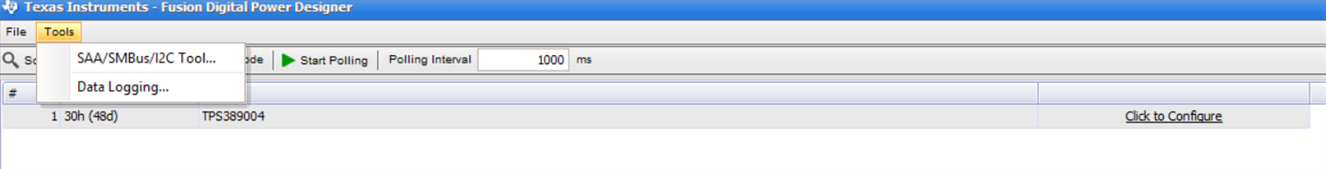

Recently, we did a monitoring test with a TPS388008001 and the evaluation board TPS389006Q1EVM on the software device TI Fusion Power Designer 7.6.6. I change the jumper's configuration to adapt TPS389006Q1EVM to TPS388008001.
Unfortunately, the software device can't recognize the TPS388008001. In fact, he detected the TPS389004 but we didn't have this component and we didn't have 4 monitoring channel but 8. So, we had to take the supervisor TPS389006 because we thinked that the probleme came to the fact that TPS388008 didn't adapt for our evaluation board. But, the software device detected again the supervisor TPS389004. So we want to know why the evaluation board TPS389006 can't recognize the good version of supervisor ?

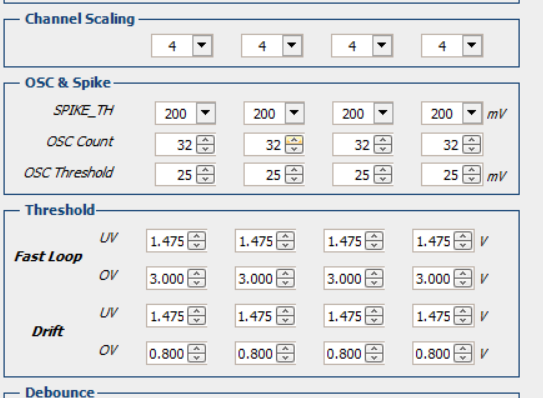

    In fact, I can write on the TPS388008001 but not in the monitoring channel 5, 6, 7 and 8 like the software shows the wrong reference. For the read, I don't know where I can see the reading of the register that I use on the software. Also, I had probleme with the adjustment of the scalling setting. I can choice the scalling x4 or x1 for OV threshold but I can't choise the scalling x4 for UV threshold.
  • Hi Issa,
    The scaling setting on both TPS38800x and TPS38900x sets the scale for monitoring as a whole, there is no individual setting for UV/OV.

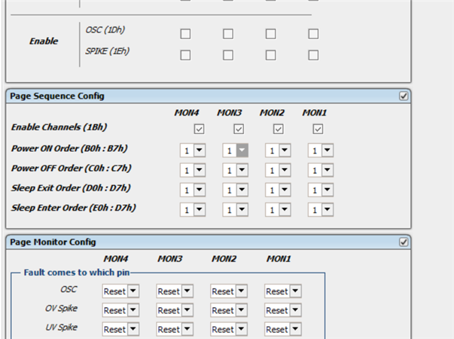

  • Hi Henry,
    I'm come back from hollidays. I have this window that appears like you:
    At beginnig, I set the commands on this pages just for scalling, monitoring channel and threshold:
    After, I seen an other window in which I can set each register with byte code. Like I noticed the name and the address of the registers on the software device is different that the name  and the address of the registers on component's datasheet, I did a code in MicroPython where I selected BANK 0 at beginning to write on the registers PROT 1, PROT 2 and PROT MON to allow changes.
    After, I selected BANK 1 to make the changes I wanted and I make changes on the registers Vmon_CTL, VMON_MISC, IEN_UVHF, IEN_OVHF, IEN_CONTROL, IEN_VENDOR, MON_CH_EN, VRANGE_MULT, UV_HF1, OV_HF1, FLT_HF1, AMSK_ON, AMSK_OFF, AMSK_EXS and AMSK_ENS.

  • Issa,
    Currently TI Fusion Digital Power Designer does not fully support TPS38800x devices, and instead shows the configuration page for TPS389xxx devices. The name of the registers in the software do not correctly map to their actual addresses, as TPS38800x and TPS389xxx have different register maps. The only way to properly configure the device using TI Fusion Digital Power Designer at this time is to use the SAA/SMBus/I2C Tool and manually configuring the registers.
    -Henry

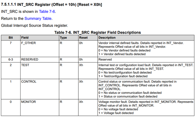

    Thanks for your help. I noticed that the write operations are better with this method like the read operation and, this time, I can see every command that is being read. There is one last problem. During my last test, I saw that there is a fault of state or communication detected on the INT_SRC register. I want to know where the problem might come from?
  • Hi Issa,
    To clarify, are you able to read the contents of the register properly or is there an error when trying to read from only this register? If you cannot read from the register using TI Fusion Digital Power Designer, please send a screenshot of the error you are encountering.
    The INT_SRC register stores information about the source of a global interrupt, and is described fully in section 7.5.1.1.1 of the datasheet.
    -Henry
  • In fact, I can read in this register but I set a voltage 0 V on channel 1 with an under-voltage threshold at 3.1 V. However, I do not read on the software a failure of the voltage monitor in the register INT_SRC because I have the data code 02h. I read this data code in this area:
    Instead of the 0x00 you see on the current image, there was 0x02 which means that there are no voltage monitor defects but status or communication defects. This is this data code who surprise me.
  • Issa,
    Per the datasheet, the details of a control interrupt are reported in the INT_CONTROL register. INT_CONTROL will explain why the interrupt was triggered.
    An under-voltage interrupt will not be generated by an under-voltage fault if the interrupt is not enabled, or if the channel monitoring is disabled. The datasheet explains the exact conditions required for generating an interrupt.
