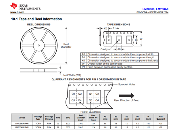

Could you please verify the T&R parameters for the LM706A0RRXR switcher?  Customer has multiple datasheets showing different values.
Would you mind confirming this is correct?

    What is shown in the LM70660/LM706A0 T&R snippet is correct.

  • Ben- turns out a customer has a Mouser tape cut. is it possible that they repackaged the tape & reel? Spacing is different on this cut.
    Mind double confirming the datasheet will be correct? Customer sent two datasheets with conflicting Q1/Q2 pin1 quadrants. Customer noted it is a small gap to put between chips and want to ensure they set up their SMT machines correctly.
    Customer also noted they have conflicting datasheets: lm706a0.pdflm70660.pdf

    I would not know whether or not Mouser would repackage the units.
    There was an issue with the older datasheets showing "Q1" as the quadrant where pin 1 is located but the datasheets have now been updated and revised with "Q2" being the correct quadrant.
