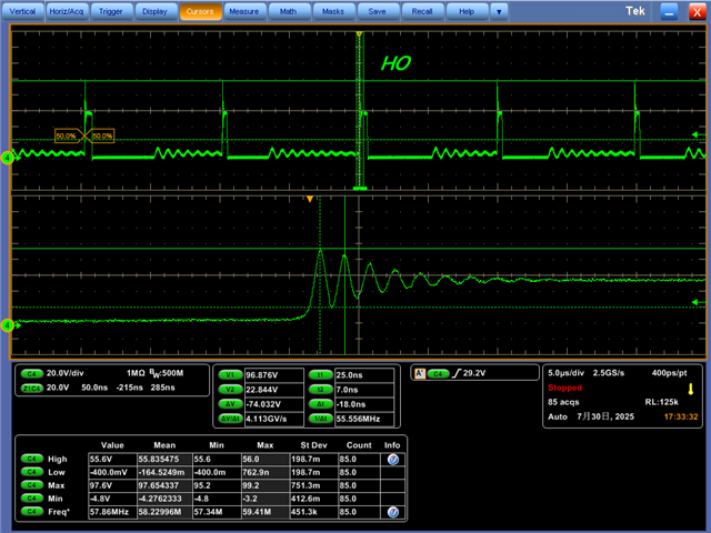

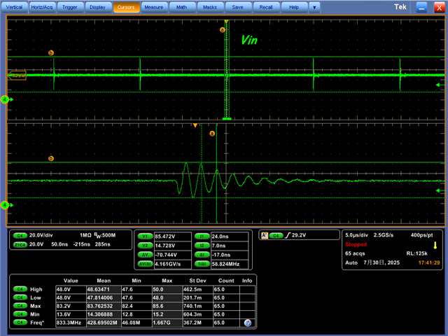

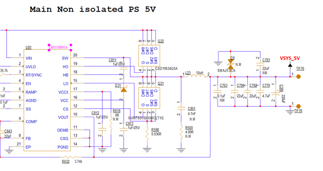

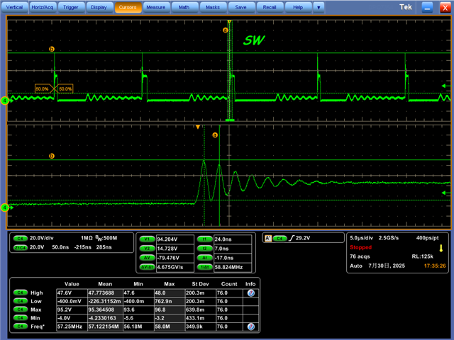

Hello:
In the client's project, TI's LM5116 is used. When measuring SW and HO, significant ringing and considerable noise on the input were observed. Could you please provide some guidance,Thanks!!!
  • Hello Jimmy
    • The switching loop should be small. Please locate low ESR ceramic capacitors between the drain of the high-side MOSFET and the ground connection of RSENSE
      https://www.ti.com/video/6285511636001
    • The diode reverse recovery charge should be small. Please populate a Schottky diode in parallel with the low-side MOSFET.
    • Switching speed should be slow, please try to add 1-5ohm gate resistor on the high-side gate and make it sure dead-time is enough after adding the gate resistor.
