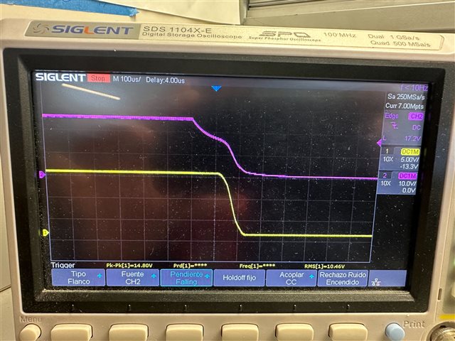

Hello
We are designing a four-cell BMS in series for INR-21700-P50B. Our application requires a 25A discharge for a few seconds. By performing some tests with a digital load, I can successfully apply a 23A discharge, but when I increase the discharge to 25A, it's as if the BQ40Z50-R5 cuts off the power for some reason I haven't been able to discover (all protections are disabled for testing purposes).
With a 23A load, the voltage drop across the battery connector is only 1.5V. I'm using two 1.5mR MOSFETs in parallel for DSG and CHG.
Below is an image captured by the oscilloscope, where purple is Vgate DSG and yellow is Vpack. Here you can see that the BQ40Z50-R5 turns off the discharge MOSFET when a 25A load is applied.
I also attach images of tests applying different currents and observing the voltage drop to ensure that the voltage is not dropping more than necessary. In the graph you can see when a satisfactory discharge is applied, the current line is maintained for a few seconds, where the line fluctuates is a failed discharge at 25A.

  • Flaco,
     Even if you disable the protections, you are only disabling the protections of the FW, not the HW. The HW protections (AOLD, ASCC, ASCD) cannot be turned off, but you can increase the thresholds to make sure they don't turn off the device. The thresholds should be in the Technical Reference Manual of the device. You can try setting them to their max value. These are extremely fast HW protection that have reaction time within 100s of us if not less.
    I took a look at your gg file, and I see your HW protections are set to the default values: -19.42mV. If your sense resistor is 1 mΩ, then -19.42mV will be -19.42A to trigger the protection.
    -Miguel
  • Oh, thank you very much. Excellent solution. This is most likely my problem. It makes perfect sense.
    Thank you very much.
    Best regards.
  • Currently I have the bit [RSNS] = 0 so the hardware protections will be x0.5, AOLD Thresold = 0xF4 which is equivalent to –19.42 mV, I should only configure the bit [RSNS] = 1 so my overload protection would increase to –38.84 mV.
