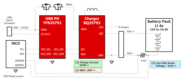

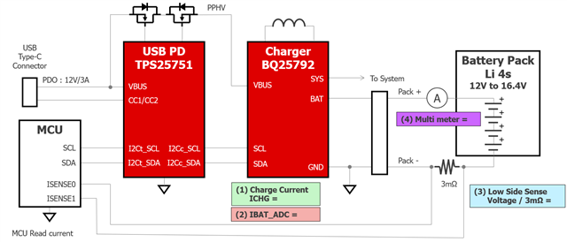

We are in the process of evaluating the BQ25792 and have a question regarding charging current.
The configurations being evaluated are as follows:
Input of BQ25792 : 12V
Load  :  The evaluation was performed using a constant voltage(CV) of 14.4V instead of an actual 4-cell battery.

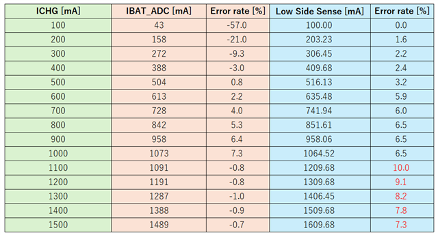

(1) Setting the charging current (ICHG) of the BQ25792.
(2) Read the charging current value (IBAT_ADC) of BQ25792.
The ADC resolution is set to 15 bits (0h) for ADC_SAMPLE_1:0 of REG2E_ADC_Control Register.
(3) The battery current is the Low Side Sense, and the actual current value is calculated by measuring the voltage across the sense resistor.
Then, We compared ICHG, IBAT_ADC and Low Side Sense.

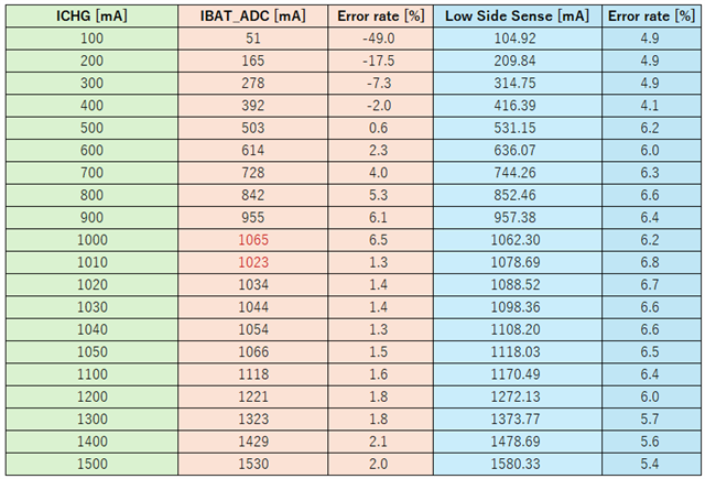

/* Measurement sample A */

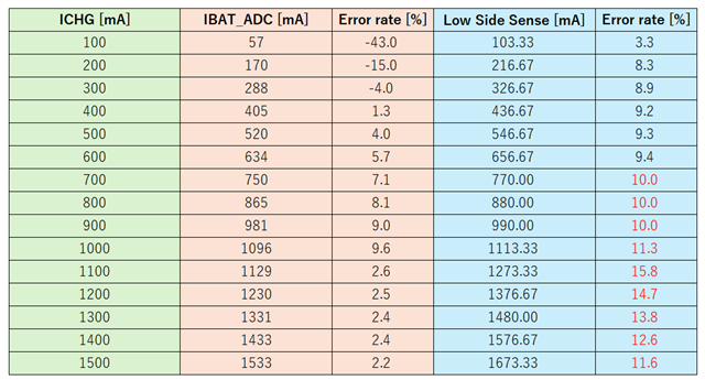

/* Measurement sample B */
[Question1.]
We can see that the current actually flowing through the battery (Low Side Sense) is higher than the current value set (ICHG) by the BQ25792.
The error seems to be particularly large when the charging current setting is high.

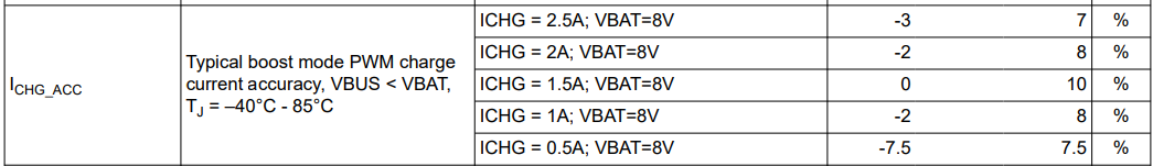

The datasheet specifies the current accuracy when charging a 2cells battery in boost mode, but does the accuracy tend to be worse than the specified accuracy when charging 4 cells?
[Question 2.]
It can be seen that the set charging current (ICHG) and the battery charging current read by the ADC (IBAT_ADC) show similar values.
Where does the IBAT_ADC of the BQ25792 measure the current flowing through?
I checked the datasheet but it doesn't seem to be mentioned.
[Question 3.]
We think 10% to 15% error is too big.
Do you know how to improve these?

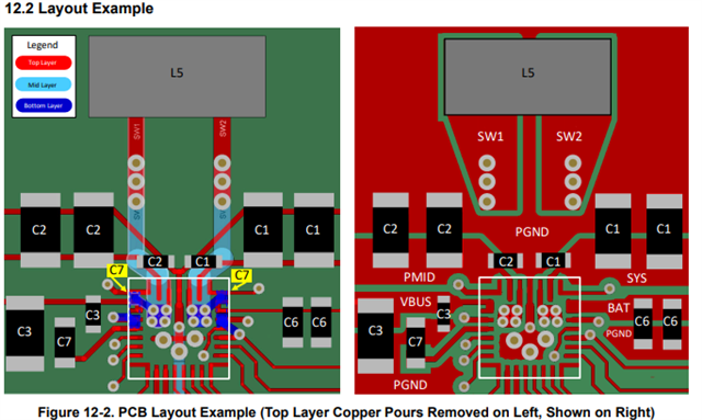

    The BQ25792 current sense amplifier is very sensitive to switching noise.  To filter out the switching noise, the BQ25792 requires the PCB layout per datasheet as shown below
    The two 0.1uF capacitors between PMID and especially SYS and GND, on same layer as the IC without vias, are required. If not, the charger can measure current incorrectly.  Does your PCBs layout follow the datasheet recommendation?

  • Hi Masashi,
    The placement of the SYS and PMID decoupling caps are critical to filter the noise.  In the datasheet recommended layout, those caps on directly on top of the IC for shortest loop.  To confirm your external measurement, can you connect to simulated battery and use its current measure feature?

  • Hello Jeff,
    We don't have a simulated battery.
    In addition to sensing the low side of the battery, We would like to sense the high side by inserting a 3m ohm sense resistor on the high side and measuring the current.
    I checked the circuit diagram again and found that there was no loop between the BQ25792 and the battery that would increase the current value.
    Masashi

  • Hello Micheal,

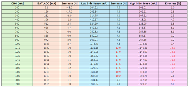

    We measured each current value when using an actual battery, but there was still a large error.
    [ Test condition A ]
    Input voltage : 12V
    Battery : 4s
    (1) Setting ICHG
    (2) Read IBAT_ADC
    (3) Low side Rsense Voltage / 3m Ohm
    (4) High side current mesurement use malti-meter
    The results show that the error becomes large at 1A or more.
    Also, since the high-side and low-side current values ​​are close to each other, it appears that the current flowing through the battery is higher than the set value.
    [ Test condition B ]
    Input voltage : 12V =>15V
    Battery : 4s
    (1) Setting ICHG
    (2) Read IBAT_ADC
    When I tried changing the input voltage from 12V to 15V, I found that the error improved slightly.
    It seems that the error tends to be larger when boosting voltage.

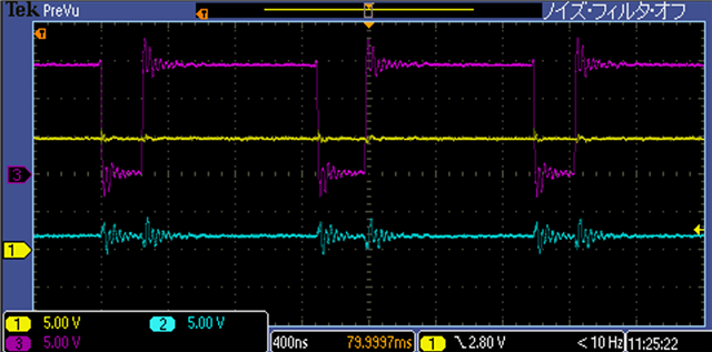

    [ Switching wave form ]
    Vin = 12V
    Battery Voltage = 14.4V
    ICHG = 1A
    Although there is some ringing due to the use of a passive probe, the output voltage appears to be stable.

  • Hi Masashi,
    It would make sense that the error is worse while in boost mode. The output ripples more in boost mode since the current is a discontinuous pulse from the inductor. This can be mitigated with more capacitance on the output, both SYS and BAT. The other possibility would be to shunt switching noise like Jeff had mentioned with decoupling capacitors. On the layout posted, I do not see anything like the C1 and C2 capacitors immediately next to the PMID and SYS as shown on the EVM layout.
    Michael

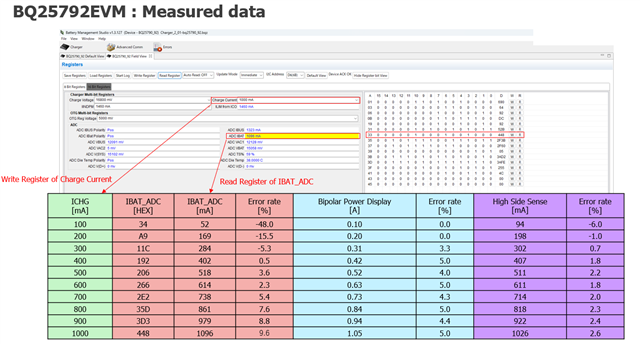

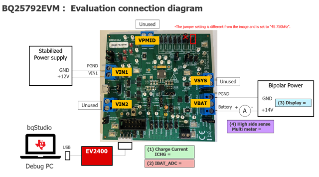

  • Hello Michael,
    We used the BQ25792EVM to evaluate the charging current.
    The register value read by bqStudio (IBAT_ADC) and the value of the calibrated digital multimeter (High Side Sense) are as follows:
    However the EVM cannot be set to a charging current of 1A or more in a 4S configuration, so it is not possible to measure currents of 1A or more.
    It can be seen that the IBAT_ADC value on the EVM is reading high once it exceeds 700mA.
    On the customer's board,
    Setting value = IBAT_ADC < Actual battery current
    On the EVM,
    Setting value = Actual battery current < IBAT_ADC

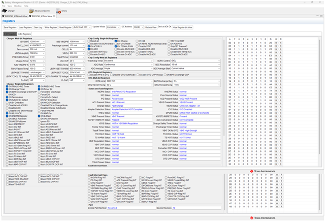

    For reference, below are the settings of each register after reading the register.
    Does this mean that the difference is caused by the board layout?
    Masashi
  • HI Masashi,
    Regarding not being able to charge higher than 1A, the BQSTUDIO pic above shows that the charger is in IINDPM, so input current is clamped.  If you set EN_ILIM =0 and then increase IINDPM register to 3.3A, the max charge current will increase.
    Regarding the ADC measurements, the datasheet does not spec absolute accuracy.  We expect the ADC to read slightly high, typically 50mA, when not running in PFM.  The termination current and ADC accuracy improves if
    1. ICHG register is set < 1A
    2. PFM is disabled
    Jeff
