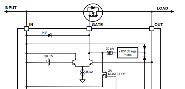

I saw two BJT(with 35uA flowed to GND) is used in LM5050 in block diagram. Can you help explain the theory of two BJT? what are they used for?

The sink current is for regulation amp which helps in maintaining a forward voltage drop of VSD_REG
