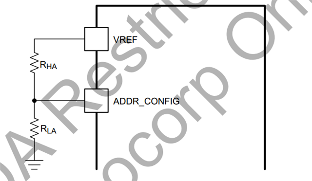

Checked the voltage at Address pin (pin 34), we are getting 0.6V which is expected as we have used (30.1k for RHA and 20k for RLA for 8+0 config as per datasheet).

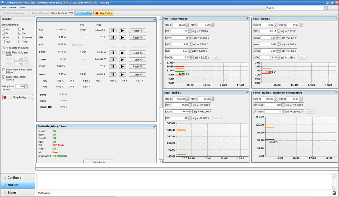

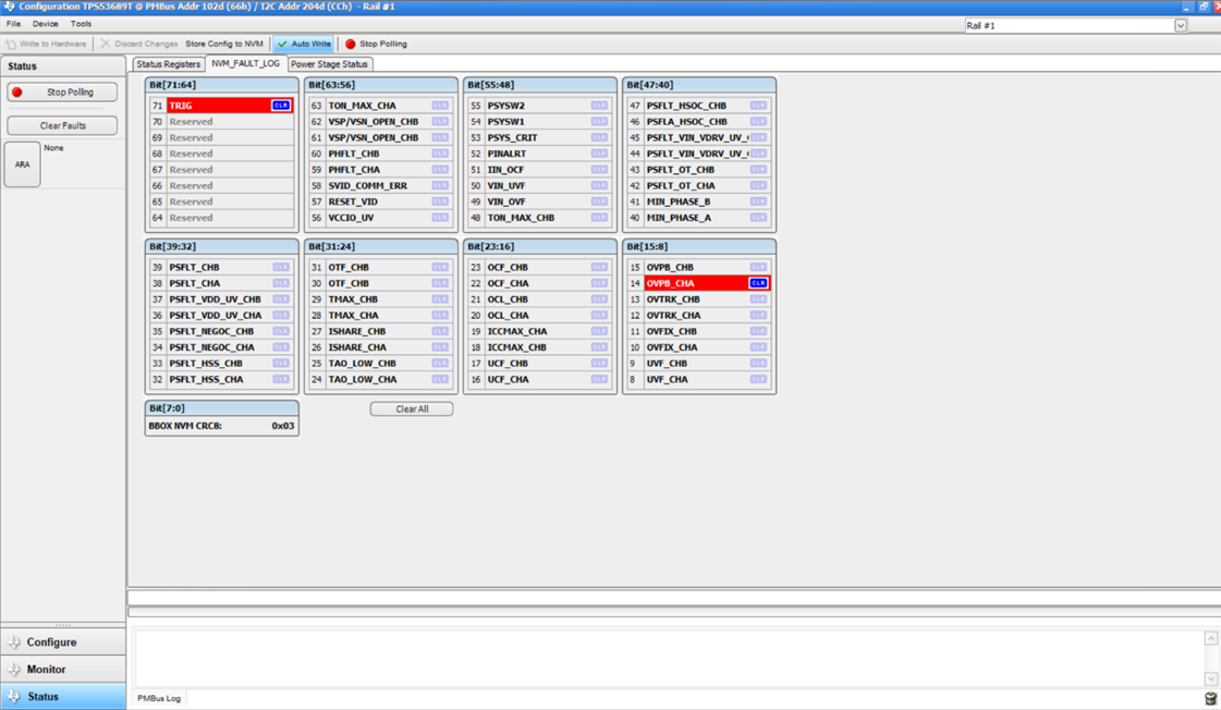

  • Hi Vasav,
    We tried to disable Ph 7 & Ph 8 phase. Now we were getting OVF fault, so we increased OVF fixed value from 2.1V to 3.1V, and now we are getting 1.92V in Fusion as shown below, but when checked using multimeter, we are getting 2.6V as this rail, now we are getting OVPB_CHA fault, TAOLOW_CHA as shown below.
    Also, the VR are getting very hot.
    We checked for the shorts, but there is no short found on the board.
    What could be the reason for this?
    Siddhi
  • Hi Siddhi,
    This is a debug activity, which requires many combination of tests.
    My first guess is that TLVR is short. Most likely, inductors with Ph 7 or 8 are are culprit.
    What was the current in each phase?
    Vasav
