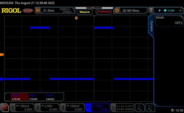

    I have attached the CC pin voltage waveform when the cable is left unconnected at the other end. We are seeing a pulsed waveform varying between 0V to 5V.
    Can we change the pull up resistor on the ID pin to 10K, is it strictly recommended to use 200K, does lowering the resistor value cause any issue for the device working?
  • Hi Sneha,
    It looks like the CC pins are properly toggling for DRP, so I don't see any issues there. If possible, I'd like to see the voltage on these pins when there is a connection to see the status then. If you could also capture VBUS and the ID pin, that would also help for getting a deeper understanding.

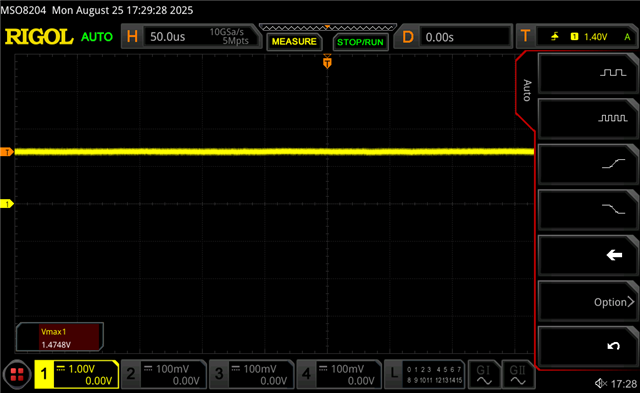

    We tested the ID pin with a 10 kΩ pull-up to the 1.8 V I/O logic of the SOM and in this case, the status is read as HIGH.
    The observed results with the 10 kΩ pull-up are as follows:
    1. DFP mode: When the system is connected to a peripheral (ex: mouse), the ID pin reads LOW at 84 mV I/O logic.
    2. UFP mode: When the system is connected to a host (laptop), the ID pin reads HIGH at 1.47 V I/O logic.
    Could you confirm if changing the pull-up resistor from 200 kΩ to 10 kΩ is acceptable. I have also attached the waveform captured in UFP mode for reference.
  • Hi Sneha,
    It looks like the ID pin is acting as expected. You aren't seeing any issue in the USB3 SS connection correct, the connection looks as expected?
    If the ID pin is operating as expected with a 10KOhm pull-up, then there isn't any problem with using a 10KOhm resistor.
