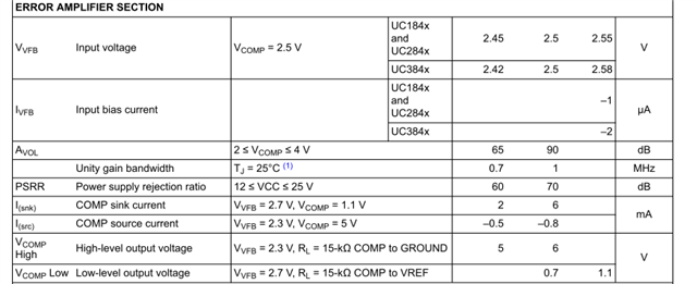

Hi Adhvaidh,
Thanks, but would it not exceed the maximum Vbe rating?
The range of emitter voltage (COMP) is 5 to 6 V, and the Base voltage range (VREF) is 4.95 to 5.1 V. In that case, VBE (max) will be 1.05 V, which is within the specs of 2907A. On top of that, there will be some drop across the resistor RSS, so it should be fine!
Thank you.
