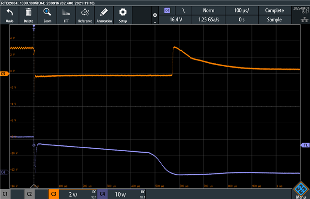

The problem we are having is that, when shorting the output, the IC gets damaged, and the Vin and SW pins short to ground. We have a half bridge on the output, and the test consists of activating the high side while the output is shorted to ground. The half bride driver has overcurrent protection, but it seems like the IC gets damaged before it activates. It fails both at 22 V and 11 V output.

    For the layout, I'd rather sent it to you in private, as it is confidential. But I have noticed that the connection of the PGND pins to the board ground is done by two 0,3 mm vias, one per pin. Do you think that this may be what is causing the problems?
  • I have soldered wires from the PGND pads to ground, and now it survives when the output is short-circuited while set at 11 V. It seems that the poor connection to ground was the issue. It still doesn't survive when set at 22 V and shorted, but it might be that the wires are too long.
    Here is a screenshot of a test when the output is at 22 V, in blue, and the driver fault signal in orange. Although the driver stops the short, after the output is restored partially, the voltage goes down, and the input gets shorted. But I guess it's just that the connection to ground still isn't good enough.

  • Hi Daniel,
    Yes, that looks to be the case. Wires like those placed during your test, can help but those also introduce extra inductances and are not as good as using a wide top side ground plane.
    Our recommendation would be to emulate the EVM for this device for layout. As you have tested this already, we are confident that this should be a good layout for your use case with this device.
