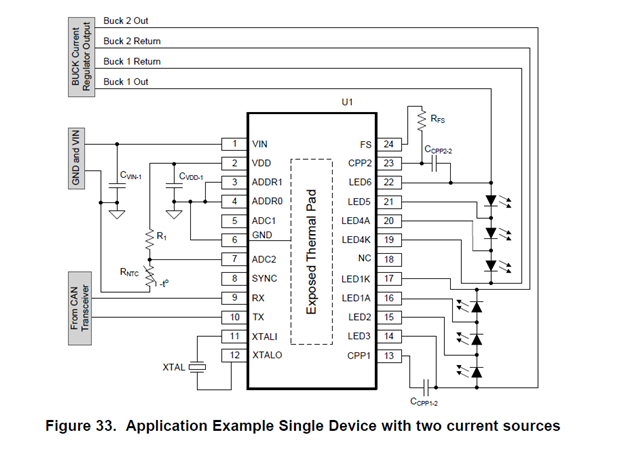

Based on the attached application example, I plan to use two LEDs per string instead of three (with Vf = 2.5V and I_LED = 5 mA). I have the following queries:
  • The datasheet mentions programmable 10-bit PWM dimming. Can we achieve 100 dimming steps with a maximum current per string of 5 mA, resulting in an approximate 50 µA step size?
  • Is it possible to feed both substrings using a single current source? Or is there an alternative approach to avoid using two separate buck current regulators?
  • If above configuration is not feasible, could you please suggest some other LED drivers, where individual LED control is present?
