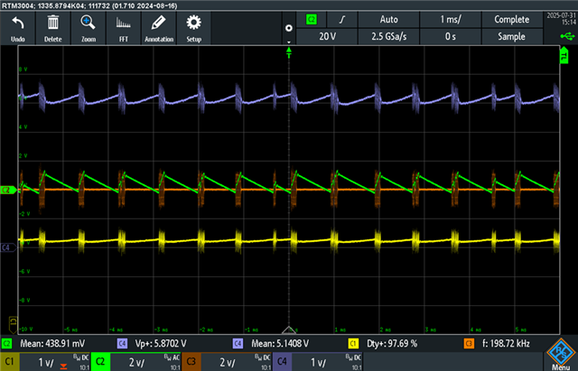

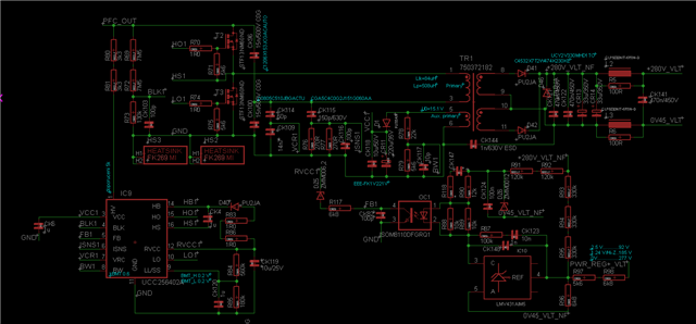

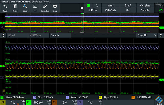

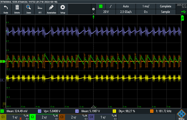

I am trying to correctly set SMPS, but I am unable to correctly set burst mode threshold.
Burst mode is turned off with load of 600 mA and more. With lower load is SMPS always in burst mode.
SMPS is possible to regulate it, but for now I am using it on 235 V output setting.
100mA load
300mA load
600 mA load

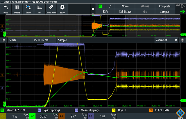

Power on condition with 1kOhm load
I will by glad for any hint.
    I am reviewing this and will get back to  you shortly.

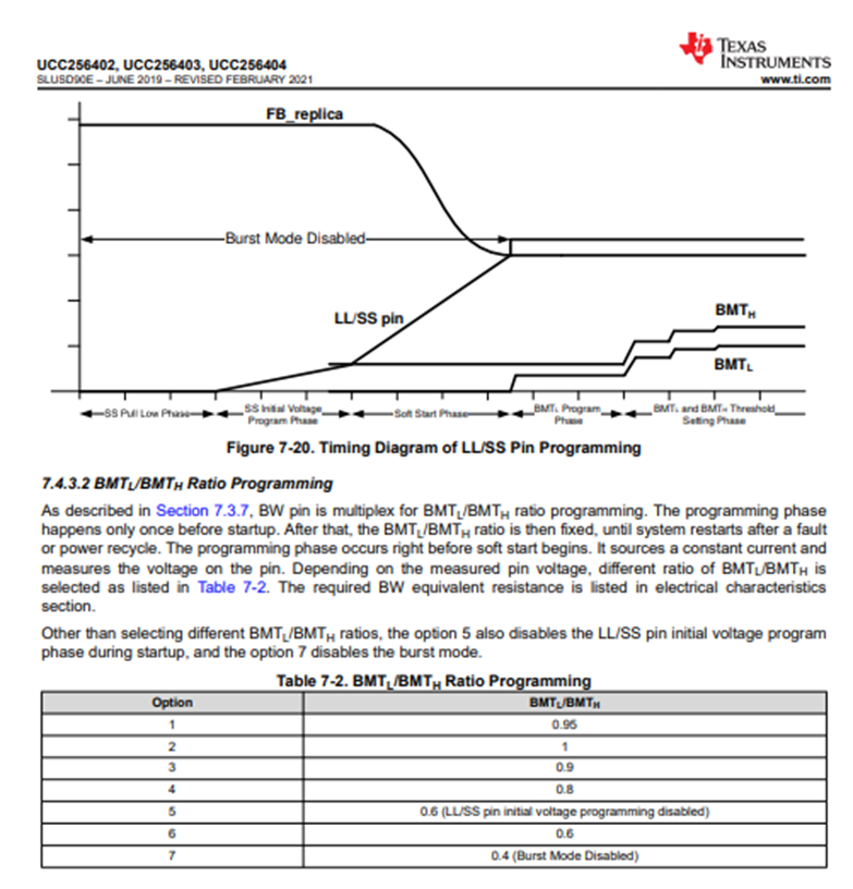

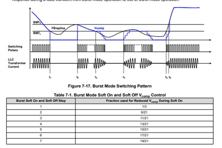

    The voltage diver on the BW pin set the burst mode levels BMTH and BMTL during power up.  The
    FBreplica voltage is generated based on the FB.
    If your design is not tripping at your desired load voltage more than likely your BMTH and BMTL thresholds are not set correctly.  The following link will bring you to an excel design tool that will calculate the resistor divider on the BW pin to set your burst mode thresholds.   This should help you resolve your issue.
    https://www.ti.com/tool/download/SLUC675
