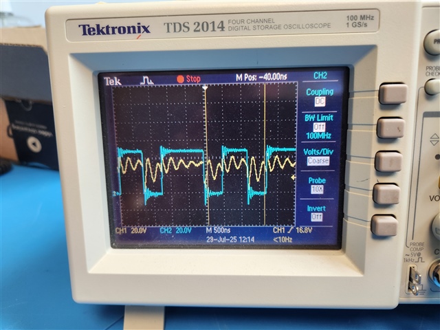

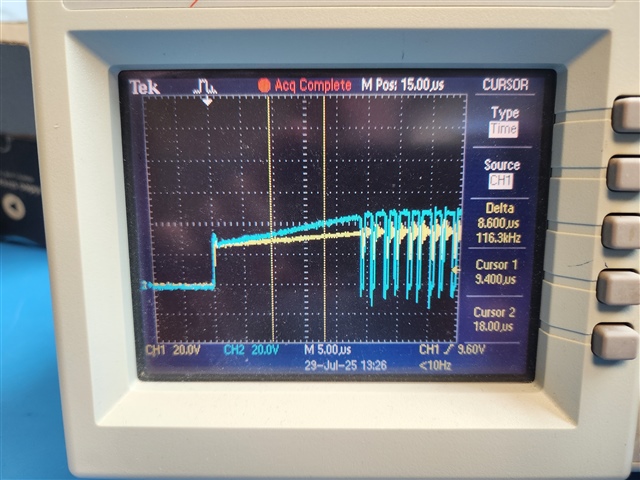

  • Failure occurs infrequently and I have not yet been able to catch any scope waveforms when the failure occurs. I have attached 2 waveforms: one during steady state operation (wfm1) at 2.5A and another at 4A at startup (wfm4). At startup the 48V and 12V are on, then the scope is triggered as the waveforms rise from an enable assertion. Yellow = LED volts out, cyan = D1,L1,Q1 node.
    I do not have information on the number of LEDs in the string we are using from our customer. At the 4A drive current the voltage is 31V (max 35V).
    On our test bench, the 48V and 12V are from separate supplies and are turned on manually. In the actual application, 48V will come up first, the 12V is derived from the 48V.
    The board only has the analog dimming circuitry installed. The PWM dimming circuit is not populated. We intend to use analog dimming only in our application. For testing the board is currently using the pot to set the IADJ pin.
    Robert D.

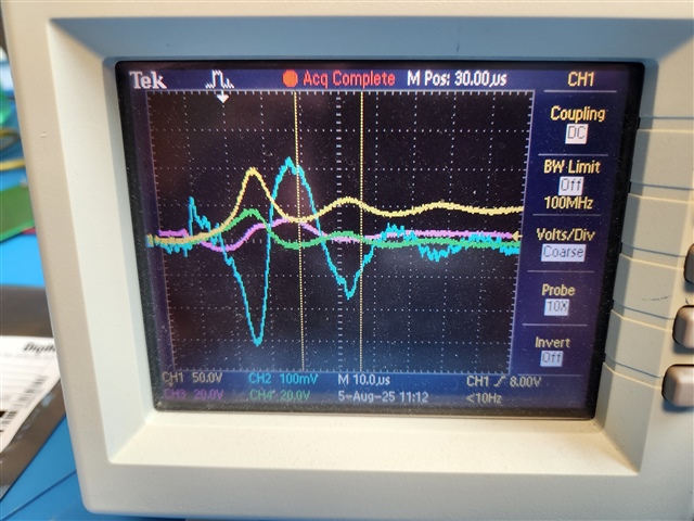

  • Attached are 2 scope traces at start-up. (yel=48V VIN, blue=LEDOUT current 100mV=1A, magenta=12V, green=LEDOUT volts)
    Wfm6 shows that the VIN from our bench supply at start-up is unstable and spikes up to 100V (which is over the 75V max LM3409HV rating). Please comment and confirm that this is likely our issue. The board did not fail, but given the waveforms, I did not continue with this power supply. This test was done with the enable pin being held low at start.
    Wfm12 is a start-up using a different power supply. The 48V DC supply is powered on with the enable asserted and the IADJ set for 4.25A. The 48V DC supply is a stable ramp up at start and the LM3409 output appears to perform as expected. Please comment.

  • Yes, this is very much likely why.  You might need to increase input capacitance or put a TVS/Zener to clamp the voltage.  I am surprised as how large the overshoot.  What is providing the 48V rail?  Is it designed to handle the load transients seen by the LED driver?  Now you know why you are blowing up the LM3409 and the P-FET not you need to figure out how to prevent it.  If you need help let me know.
    -fhoude
