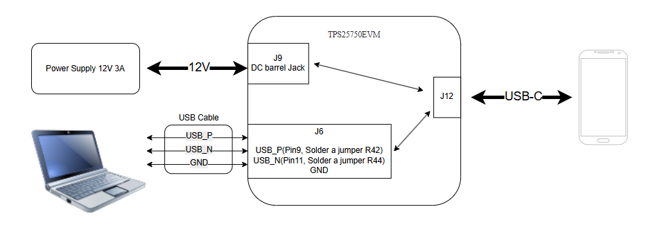

We are testing the TPS25750EVM and have a setup similar to the attached diagram.
The board successfully charges the mobile phone. However, the PC is unable to establish a data connection with the mobile phone.
We have already configured the TPS25750 to Dual-Role Power (DRP) using the TI Application Customization Tool, but the data transfer is still not working.
