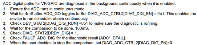

VF/GPIO Measurement Digital Diagnostic:
The Digital diagnostic measurement for VF and GPIO measurement is performed and checked the main channel processing with redundant channels(ADCs). The timing to complete the digital diagnostic measurement(VF1 , VF2, GP1 and GP3) and raising the fault register will take 100ms(as mentioned in below snippet). Is the understanding correct??
Is there any way to reduce this diagnostic measurement as analog measurement is taking just 4.4ms??
